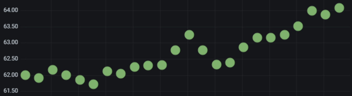

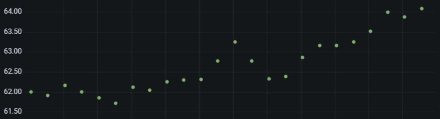

Point size
Set the size of the points, from 1 to 40 pixels in diameter.
Point size set to 6:

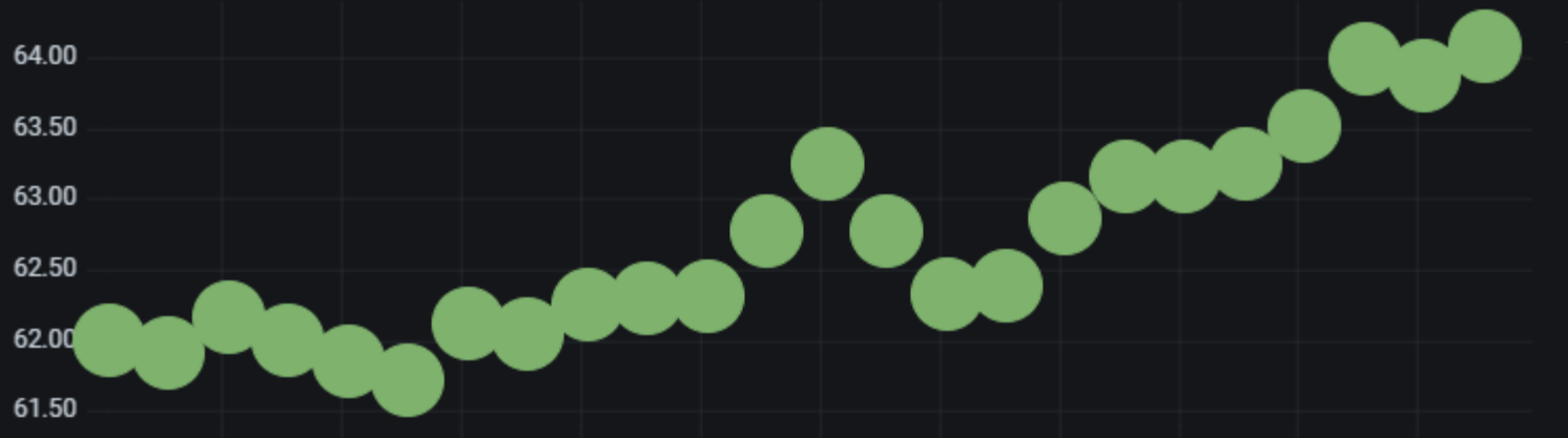

Point size set to 20:
Point size set to 35:
