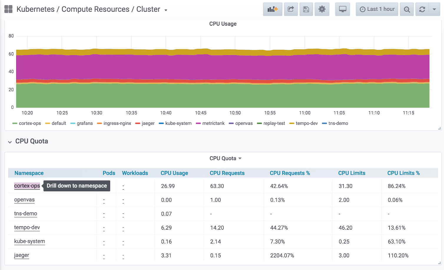

Hierarchical dashboards with drill-downs to the next level.
![Example of using drill-down Example of using drill-down]()

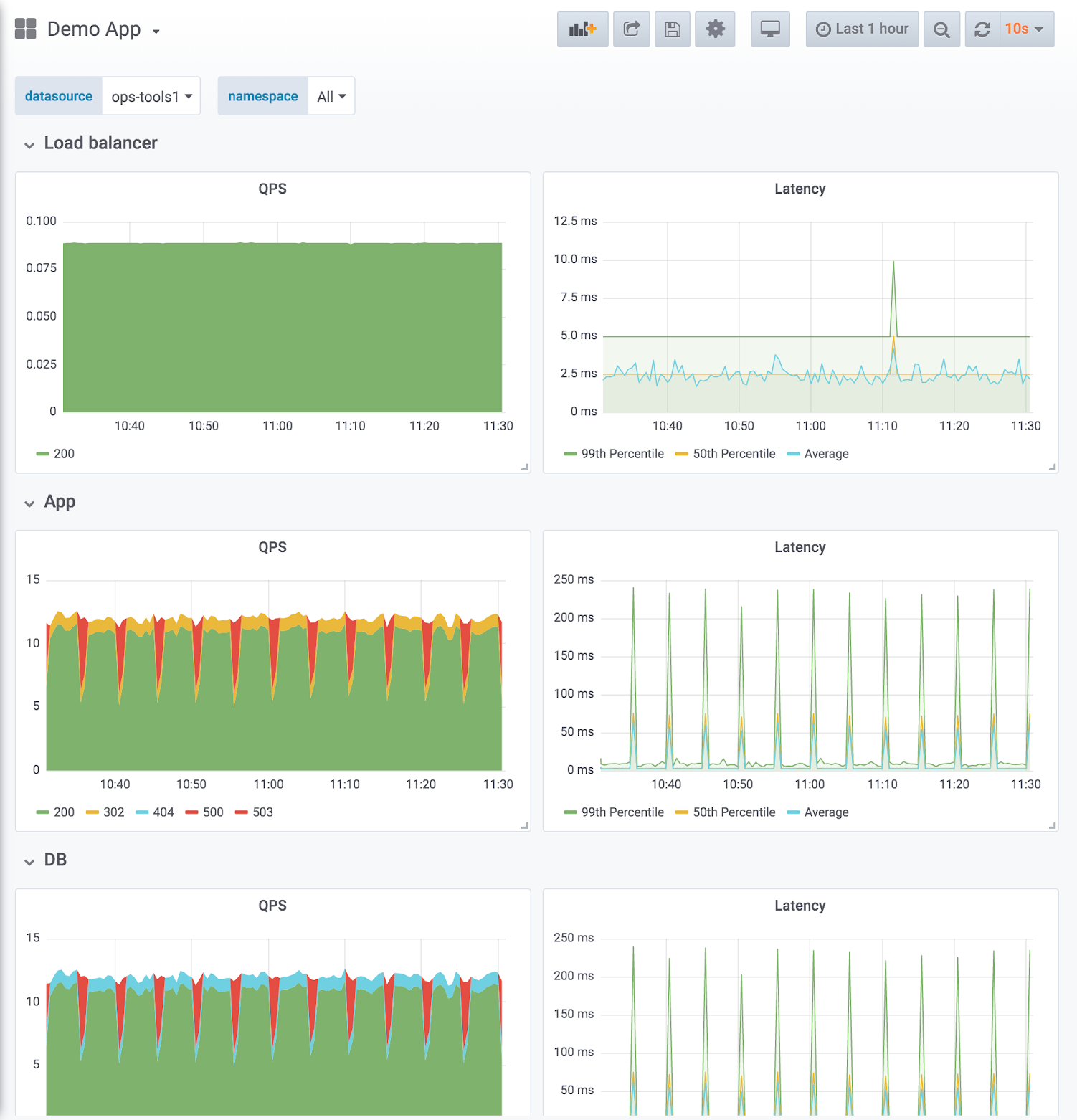

Example of using drill-down Dashboard design reflects service hierarchies. The example shown below uses the RED method (request and error rate on the left, latency duration on the right) with one row per service. The row order reflects the data flow.
![Example of a service hierarchy Example of a service hierarchy]()
Example of a service hierarchy Compare like to like: split service dashboards when the magnitude differs. Make sure aggregated metrics don’t drown out important information.
