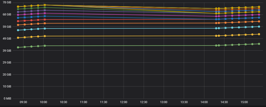

Handling or rendering null data is wrong/confusing/weird
Some applications publish data intermittently; for example, they only post a metric when an event occurs. By default, Grafana graphs connect lines between the data points. This can be very deceiving.
In the picture below we have enabled:
- Points and 3-point radius to highlight where data points are actually present.
- Null value is set to connected.

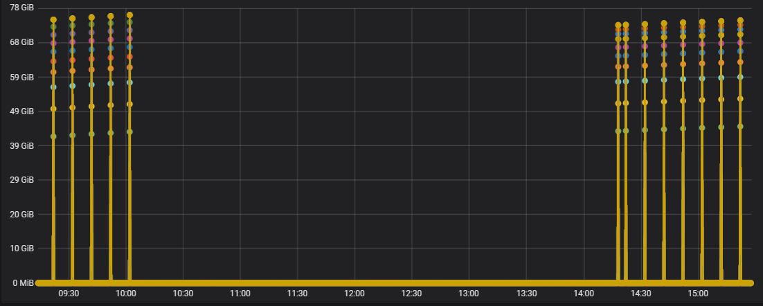

In this graph, we set graph to show bars instead of lines and set the Null value to graph null as zero. There is a very big different in the visuals.
