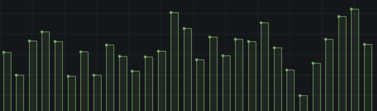

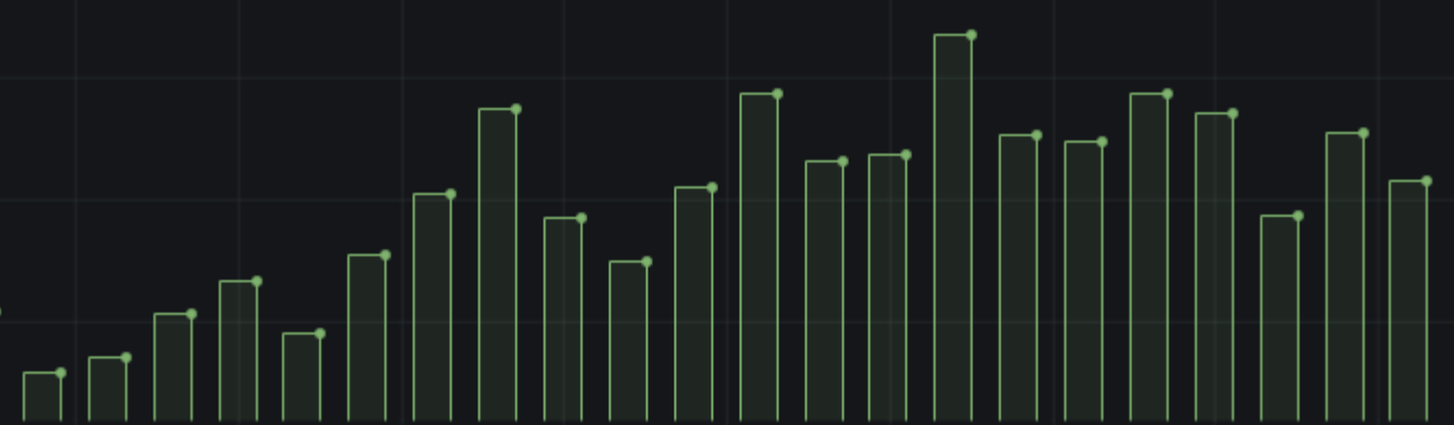

Set the position of the bar relative to a data point. In the examples below, Show points is set to Always to make it easier to see the difference this setting makes. The points do not change; the bars change in relationship to the points.
Before
The bar is drawn before the point. The point is placed on the trailing corner of the bar.
Center
The bar is drawn around the point. The point is placed in the center of the bar. This is the default.
After
The bar is drawn after the point. The point is placed on the leading corner of the bar.

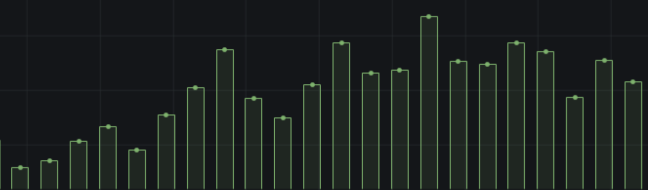

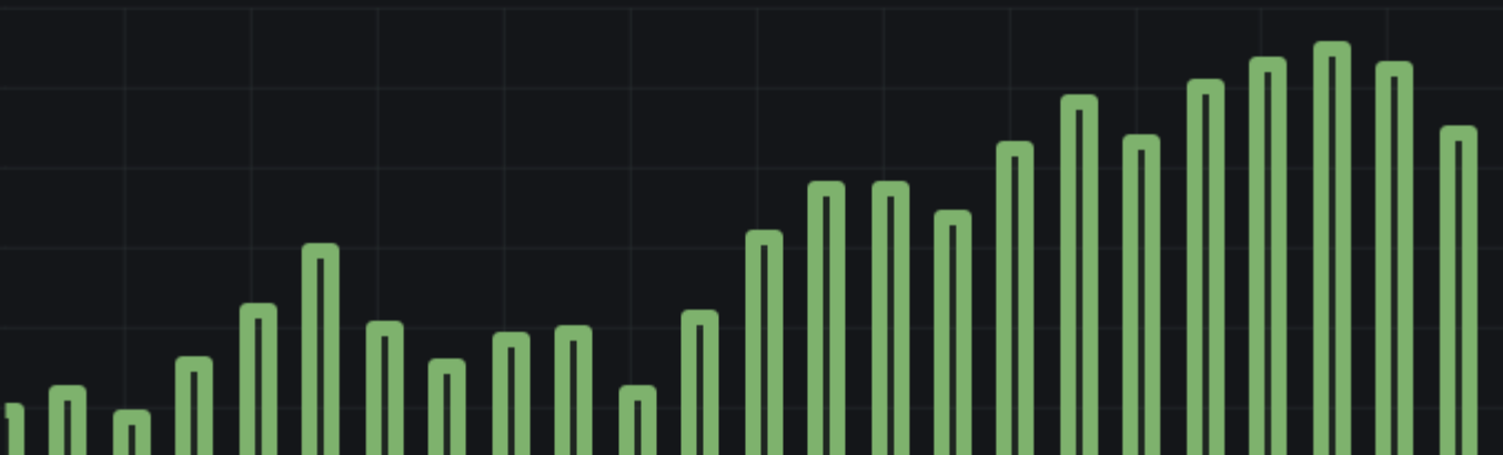

Line width

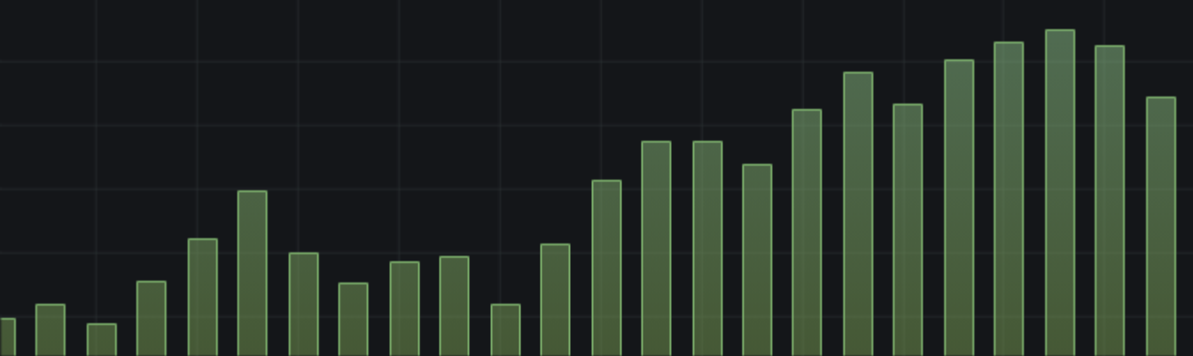

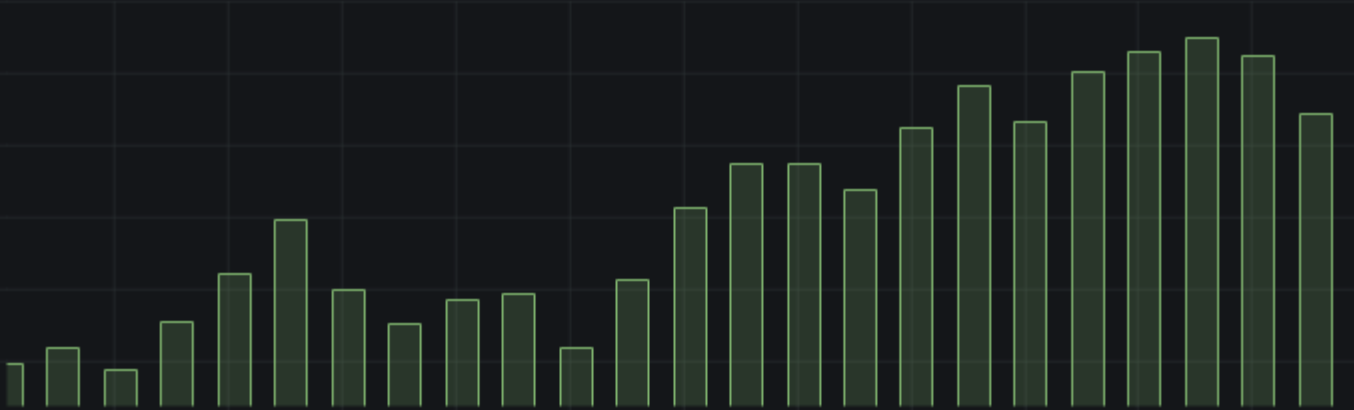

Set the thickness of the lines bar outlines, from 0 to 10 pixels. Fill opacity is set to 10 in the examples below.
Line thickness set to 1:
Line thickness set to 7:

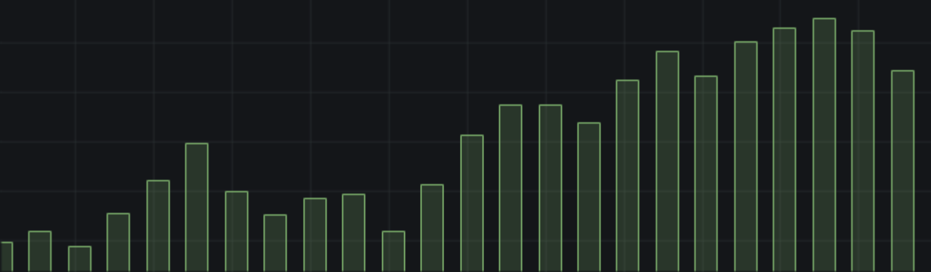

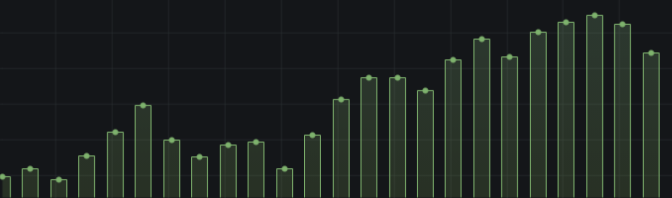

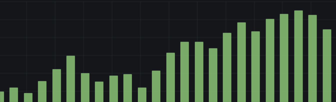

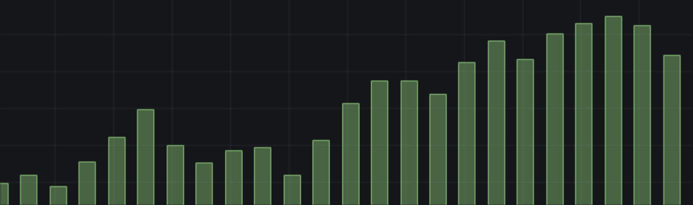

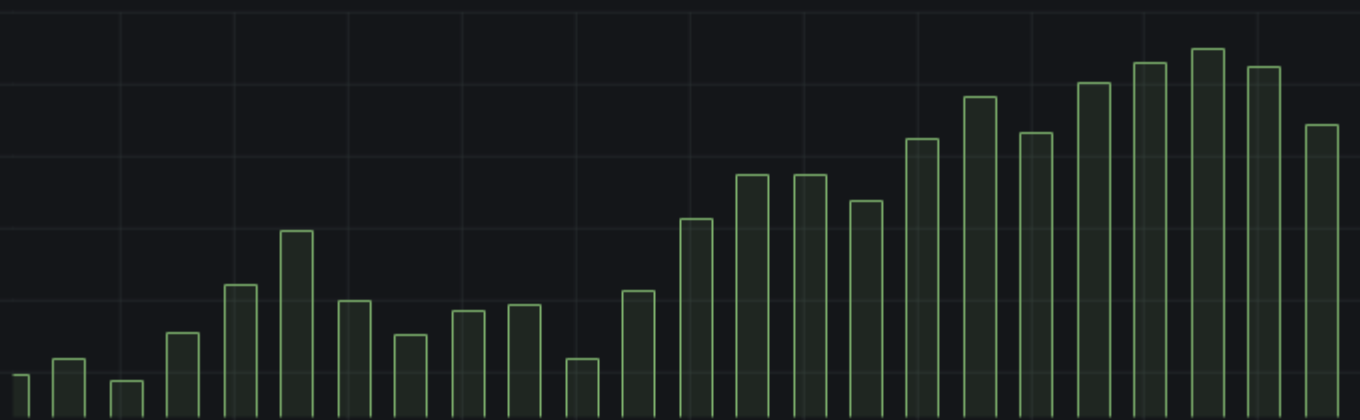

Fill opacity
Set the opacity of the bar fill, from 0 to 100 percent. In the examples below, the Line width is set to 1.
Fill opacity set to 20:
Fill opacity set to 95:

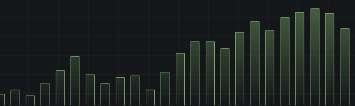

Gradient mode
Set the mode of the gradient fill. Fill gradient is based on the line color. To change the color, use the standard color scheme field option. For more information, refer to Apply color to series and fields.
Gradient appearance is influenced by the Fill opacity setting. In the screenshots below, Fill opacity is set to 50.
None
No gradient fill. This is the default setting.
Opacity
Transparency of the gradient is calculated based on the values on the y-axis. Opacity of the fill is increasing with the values on the Y-axis.

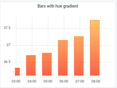

Hue
Gradient color is generated based on the hue of the line color.

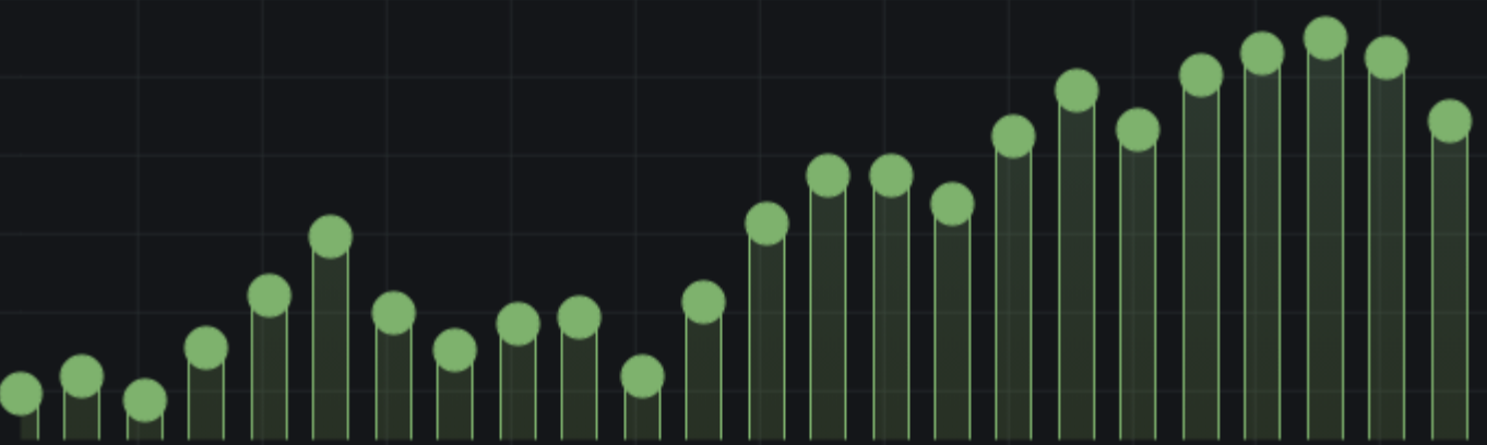

Point size
Set the size of the points, from 1 to 40 pixels in diameter.
Point size set to 6:
Point size set to 20:

Hue gradient
