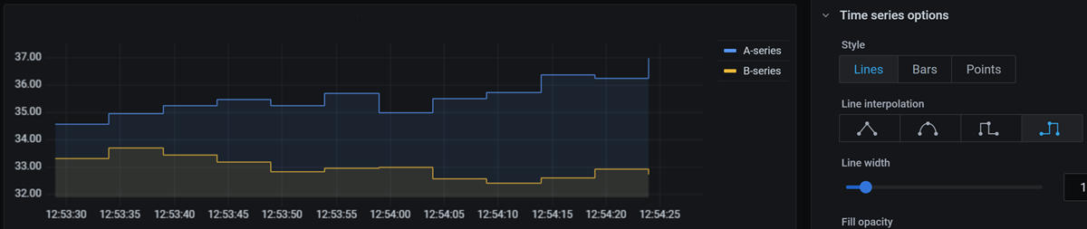

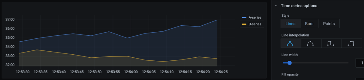

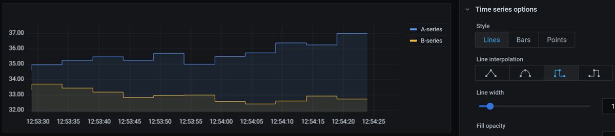

Line interpolation
Choose how Grafana interpolates the series line. The screenshots below show the same data displayed with different line interpolations.
Linear
Points are joined by straight lines.

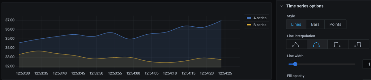

Smooth
Points are joined by curved lines resulting in smooth transitions between points.
Step before
The line is displayed as steps between points. Points are rendered at the end of the step.
Step after
Line is displayed as steps between points. Points are rendered at the beginning of the step.

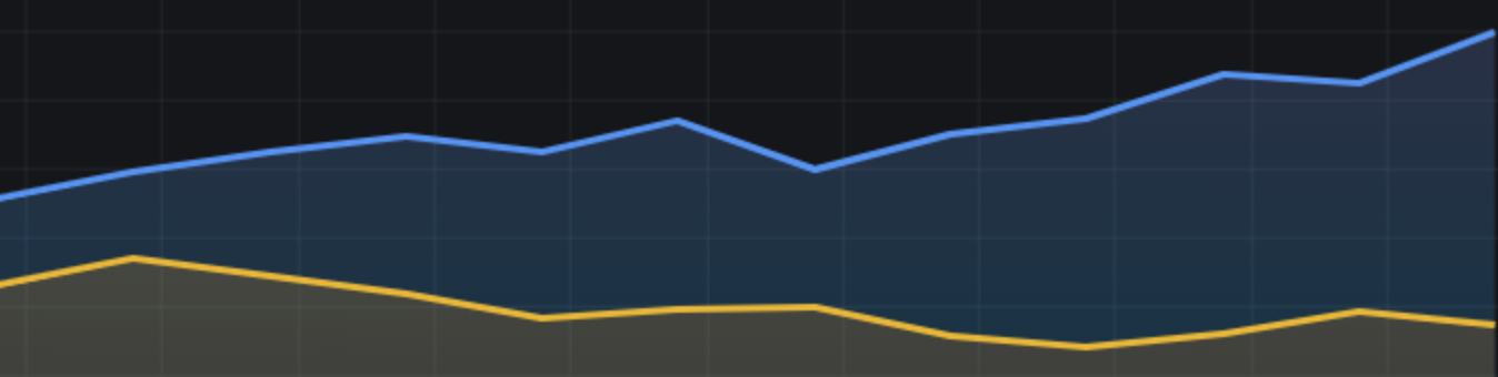

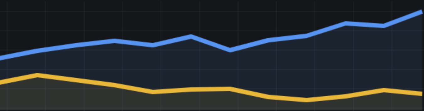

Line width
Set the thickness of the series line, from 0 to 10 pixels.
Line thickness set to 1:
Line thickness set to 7:

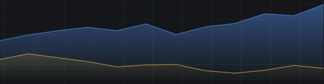

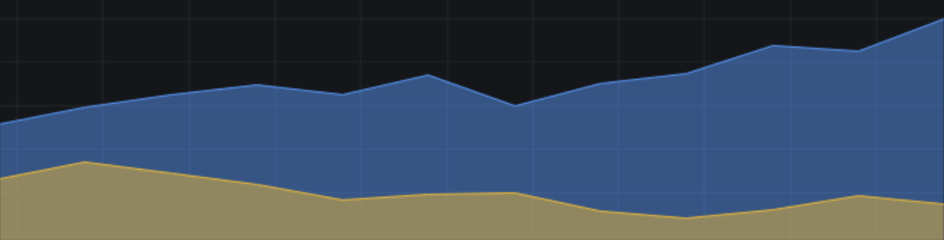

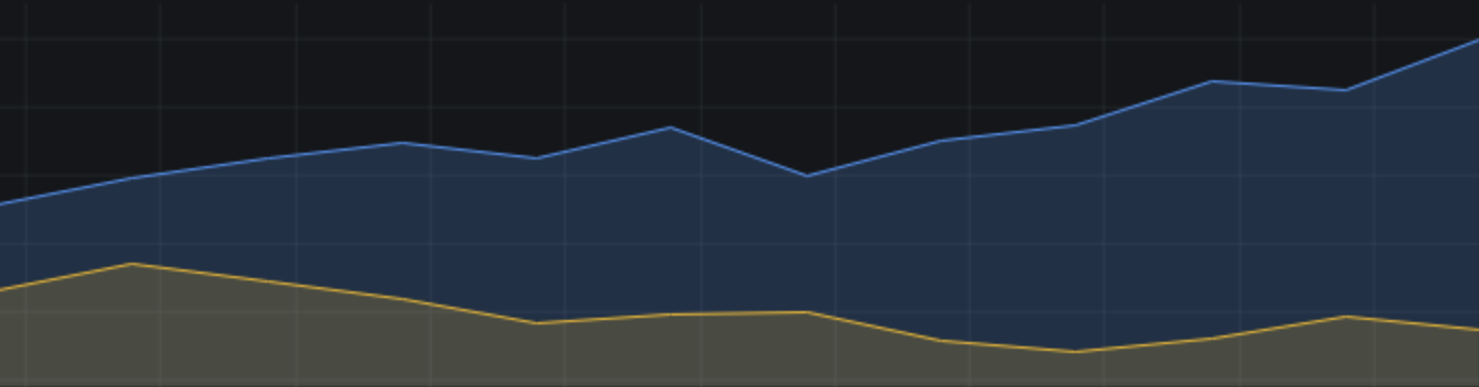

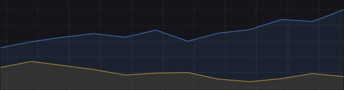

Fill opacity
Set the opacity of the series fill, from 0 to 100 percent.
Fill opacity set to 20:
Fill opacity set to 95:

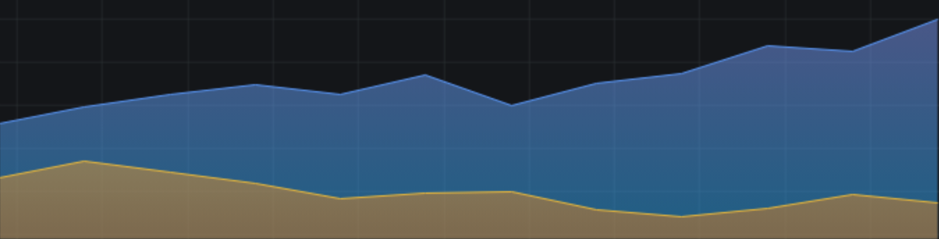

Gradient mode
Set the mode of the gradient fill. Fill gradient is based on the line color. To change the color, use the standard color scheme field option. For more information, refer to Apply color to series and fields .
Gradient appearance is influenced by the Fill opacity setting. In the screenshots below, Fill opacity is set to 50.
None
No gradient fill. This is the default setting.
Opacity
Transparency of the gradient is calculated based on the values on the y-axis. Opacity of the fill is increasing with the values on the Y-axis.

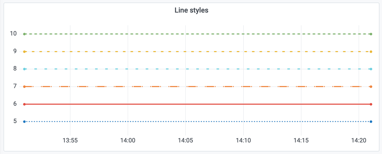

Line style
Set the style of the line. To change the color, use the standard color scheme field option. For more information, refer to Apply color to series and fields
Line style appearance is influenced by the Line width and Fill opacity settings. In the screenshots below, Line width is set to 3 and Fill opacity is set to 20.
Solid
Display solid line. This is the default setting.

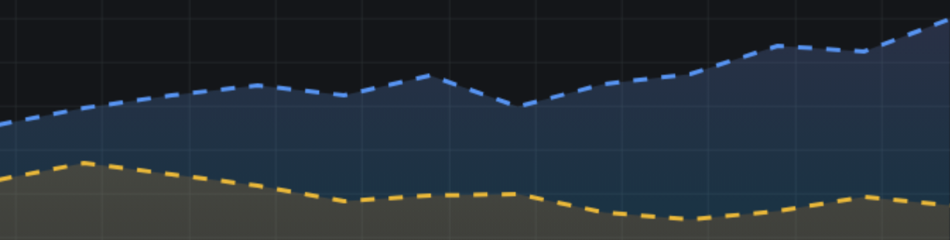

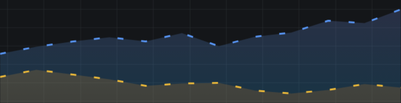

Dash
Display a dashed line. When you choose this option, a list appears so that you can select the length and gap (length, gap) for the line dashes.
Dash spacing set to 10, 10 (default):
Dash spacing set to 10, 30:
Dash spacing set to 40, 10:
Dots
Display dotted lines. When you choose this option, a list appears so that you can select the gap (length = 0, gap) for the dot spacing.
Dot spacing set to 0, 10 (default):
Dot spacing set to 0, 30:

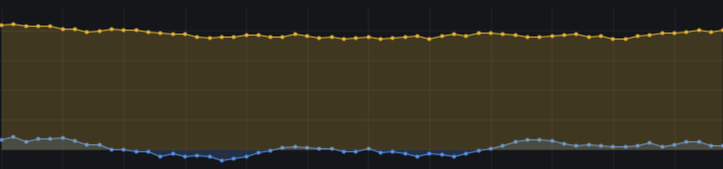

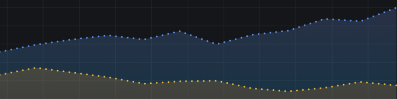

Show points
Choose when the points should be shown on the graph.
Auto
Grafana automatically decides whether or not to show the points depending on the density of the data. If the density is low, then points are shown.
Always
Show the points no matter how dense the data set is. This example uses a Line width of 1 and 50 data points. If the line width is thicker than the point size, then the line obscures the points.
Point size
Set the size of the points, from 1 to 40 pixels in diameter.
Point size set to 4:
Point size set to 10:

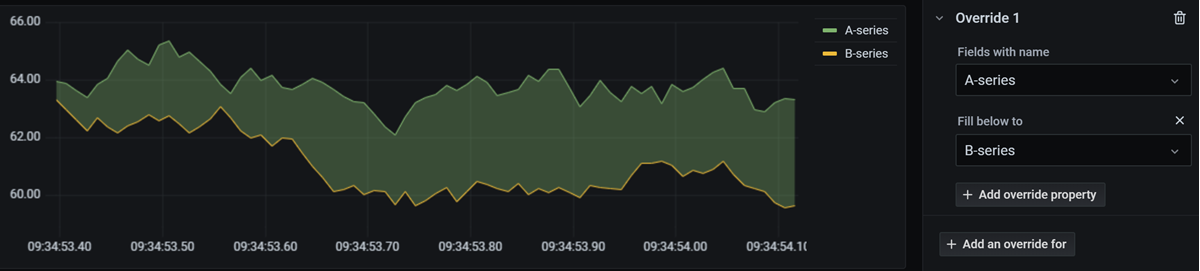

Fill below to
This option is only available as in the Overrides tab.
Fill the area between two series. On the Overrides tab:
- Select the fields to fill below.
- In Add override property, select Fill below to.
- Select the series that you want the fill to stop at.

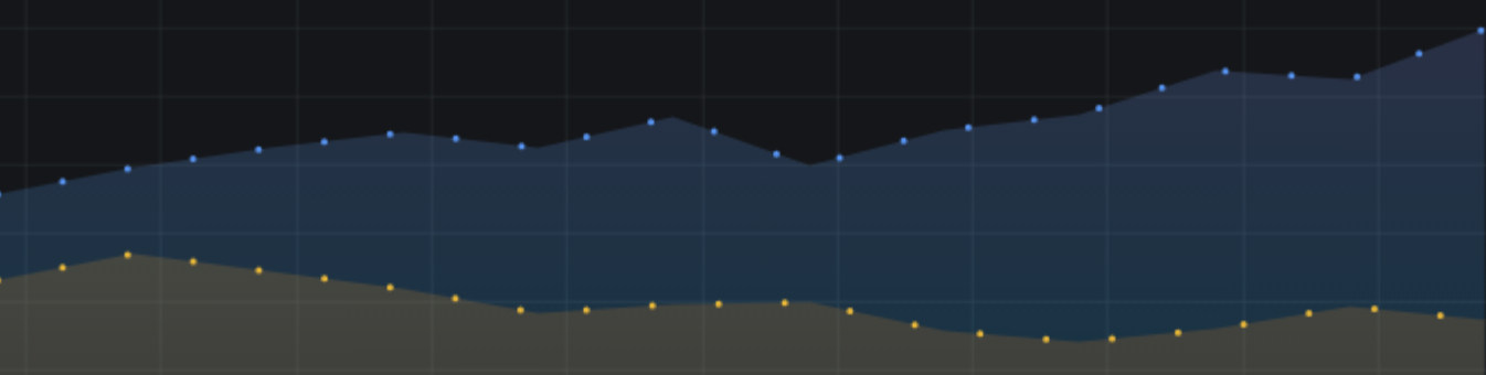

A-series filled below to B-series:

Various line styles
This is a graph with different line styles and colors applied to each series and zero fill.

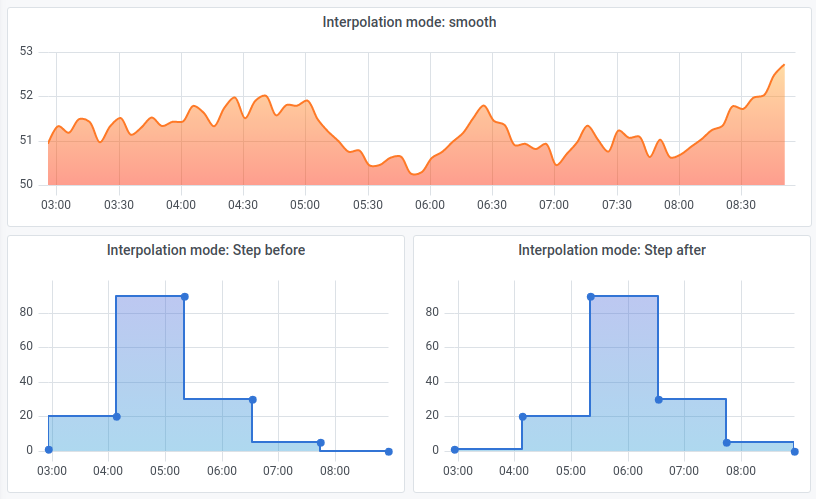

Interpolation modes examples

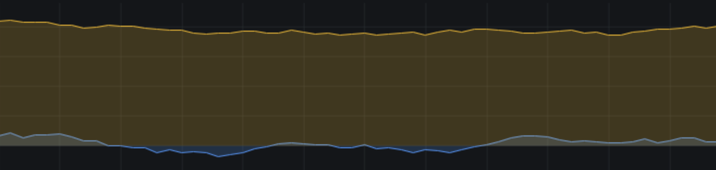

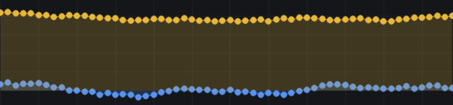

Fill below example
This graph shows three series: Min, Max, and Value. The Min and Max series have Line width set to 0. Max has a Fill below to override set to Min, which fills the area between Max and Min with the Max line color.
