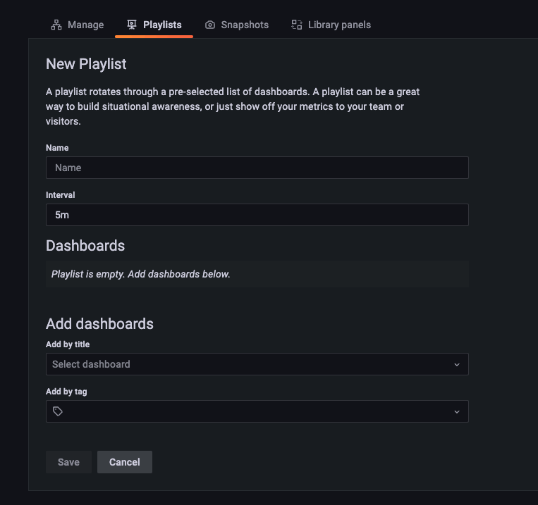

Create a playlist
You can create a playlist to present dashboards in a sequence, with a set order and time interval between dashboards.
- In the playlist page, click New playlist. The New playlist page opens.
- In the Name text box, enter a descriptive name.
- In the Interval text box, enter a time interval. Grafana displays a particular dashboard for the interval of time specified here before moving on to the next dashboard.
- In Dashboards, add existing dashboards to the playlist using Add by title and Add by tag drop-down options. The dashboards you add are listed in a sequential order.
- If needed:
- Search for a dashboard by its name, a regular expression, or a tag.
- Filter your results by starred status or tags.
- If needed, rearrange the order of the dashboard you have added using the up and down arrow icon.
- Optionally, remove a dashboard from the playlist by clicking the x icon beside dashboard.
- Click Save.
