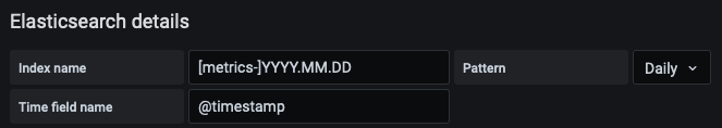

Here you can specify a default for the time field and specify the name of your Elasticsearch index. You can use
a time pattern for the index name or a wildcard.

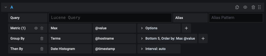

The Elasticsearch query editor allows you to select multiple metrics and group by multiple terms or filters. Use the plus and minus icons to the right to add/remove metrics or group by clauses. Some metrics and group by clauses haves options, click the option text to expand the row to view and edit metric or group by options.

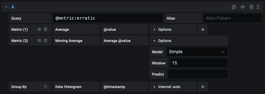

Pipeline metrics
Some metric aggregations are called Pipeline aggregations, for example, Moving Average and Derivative. Elasticsearch pipeline metrics require another metric to be based on. Use the eye icon next to the metric to hide metrics from appearing in the graph. This is useful for metrics you only have in the query for use in a pipeline metric.

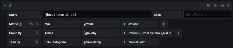

There are two syntaxes:
$<varname>Example: hostname:$hostname[[varname]]Example: hostname:[[hostname]]
Why two ways? The first syntax is easier to read and write but does not allow you to use a variable in the middle of a word. When the Multi-value or Include all value options are enabled, Grafana converts the labels from plain text to a lucene compatible condition.
In the above example, we have a lucene query that filters documents based on the hostname property using a variable named $hostname. It is also using
a variable in the Terms group by field input box. This allows you to use a variable to quickly change how the data is grouped.
Example dashboard: Elasticsearch Templated Dashboard

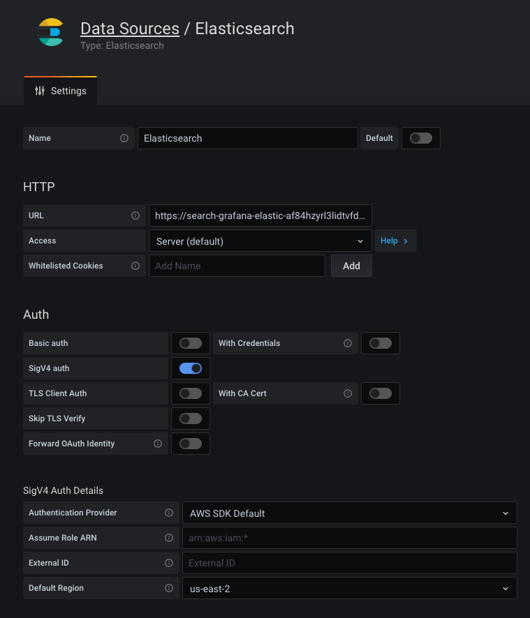

AWS users using Amazon’s Elasticsearch Service can use Grafana’s Elasticsearch data source to visualize Elasticsearch data. If you are using an AWS Identity and Access Management (IAM) policy to control access to your Amazon Elasticsearch Service domain, then you must use AWS Signature Version 4 (AWS SigV4) to sign all requests to that domain. For more details on AWS SigV4, refer to the AWS documentation.
AWS Signature Version 4 authentication
Note: Only available in Grafana v7.3+.
In order to sign requests to your Amazon Elasticsearch Service domain, SigV4 can be enabled in the Grafana configuration.
Once AWS SigV4 is enabled, it can be configured on the Elasticsearch data source configuration page. Refer to Cloudwatch authentication for more information about authentication options.
