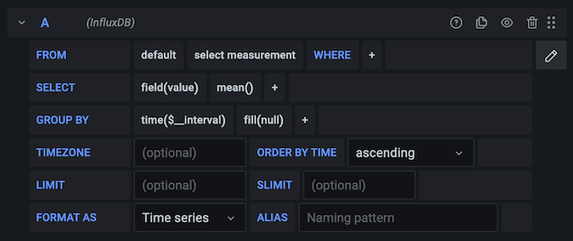

InfluxQL query editor
Enter edit mode by clicking the panel title and clicking Edit. The editor allows you to select metrics and tags.
Filter data (WHERE)
To add a tag filter, click the plus icon to the right of the WHERE condition. You can remove tag filters by clicking on the tag key and then selecting --remove tag filter--.
