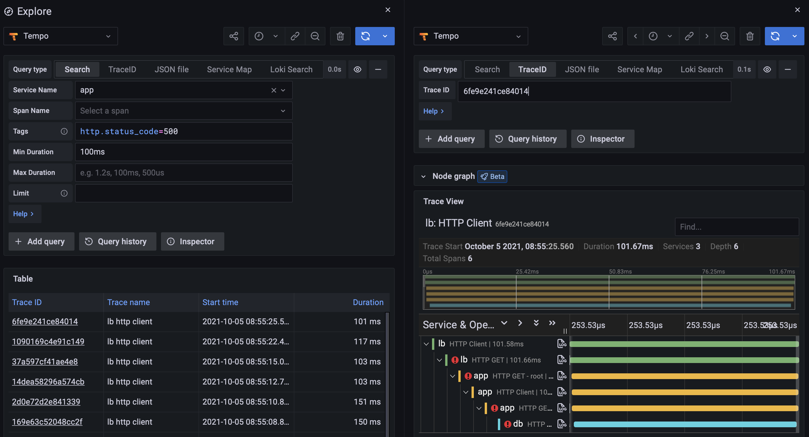

Tempo search is an experimental feature behind a feature toggle. Use this to search for traces by service name, span name, duration range, or process-level attributes that are included in your application’s instrumentation, such as HTTP status code and customer ID.
Screenshot of the Tempo search feature with a trace rendered in the right panel
Search recent traces
Tempo allows you to search recent traces held in the ingesters. By default, ingesters store the last 15 minutes of tracing data, and this search is disabled. Enable this search capability by setting the tempoSearch feature toggle.

Screenshot of the Tempo query editor showing the search tab
To query a particular trace, select the TraceID query type, and then put the ID into the Trace ID field.
Screenshot of the Tempo TraceID query type
