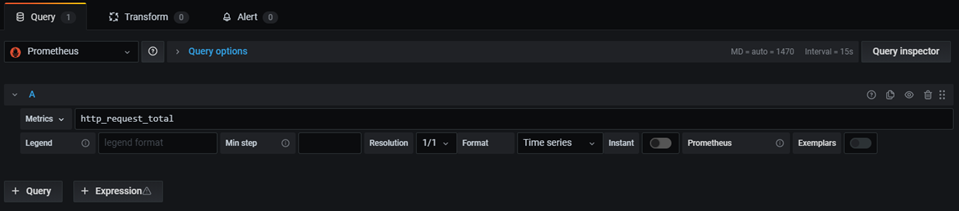

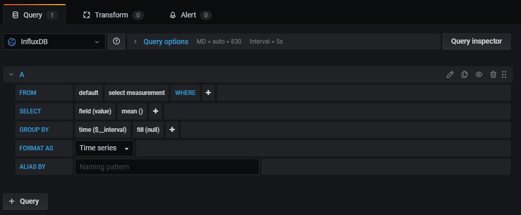

Because of the difference between query languages, data sources have query editors that look different. Here are two examples of query editors.
InfluxDB query editor
Prometheus (PromQL) query editor
