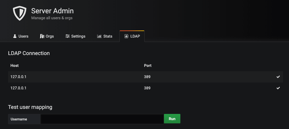

Only available in Grafana v6.4+
Grafana has an LDAP debug view built-in which allows you to test your LDAP configuration directly within Grafana. At the moment of writing, only Grafana admins can use the LDAP debug view.
Within this view, you’ll be able to see which LDAP servers are currently reachable and test your current configuration.
To use the debug view:

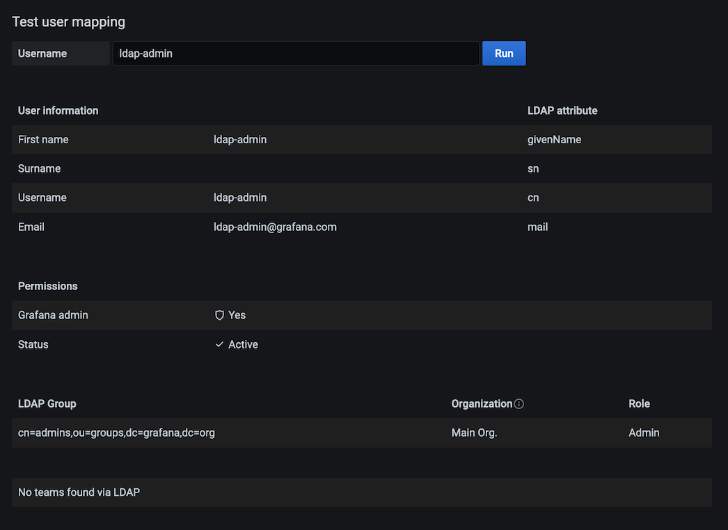

- Type the username of a user that exists within any of your LDAP server(s)
- Then, press “Run”
- If the user is found within any of your LDAP instances, the mapping information is displayed
