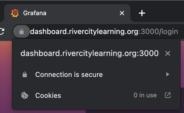

The following image shows a browser lock icon which confirms the connection is safe.

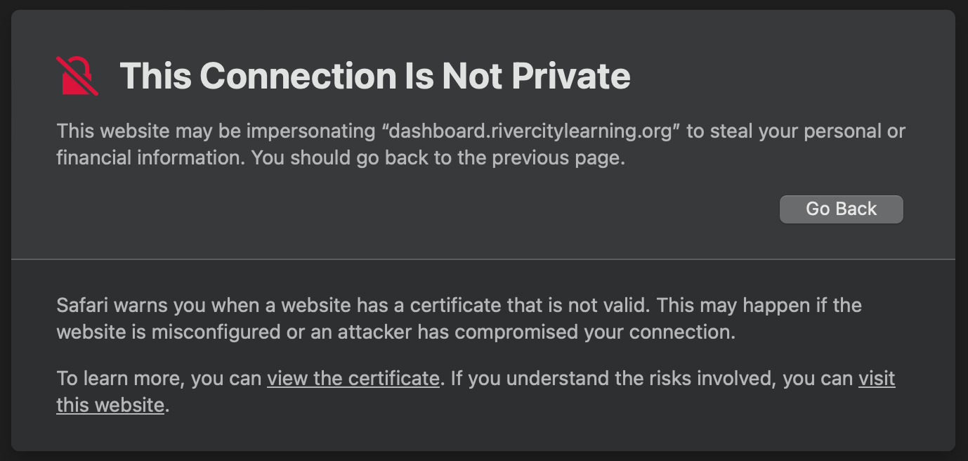

sudo chown grafana:grafana /etc/grafana/grafana.crt sudo chown grafana:grafana /etc/grafana/grafana.key sudo chmod 400 grafana.key /etc/grafana/grafana.crtNote: When using these files, browsers might provide warnings for the resulting website because a third-party source does not trust the certificate. Browsers will show trust warnings; however, the connection will remain encrypted.
The following image shows an insecure HTTP connection.
![Insecure HTTPS connection Insecure HTTPS connection]()
