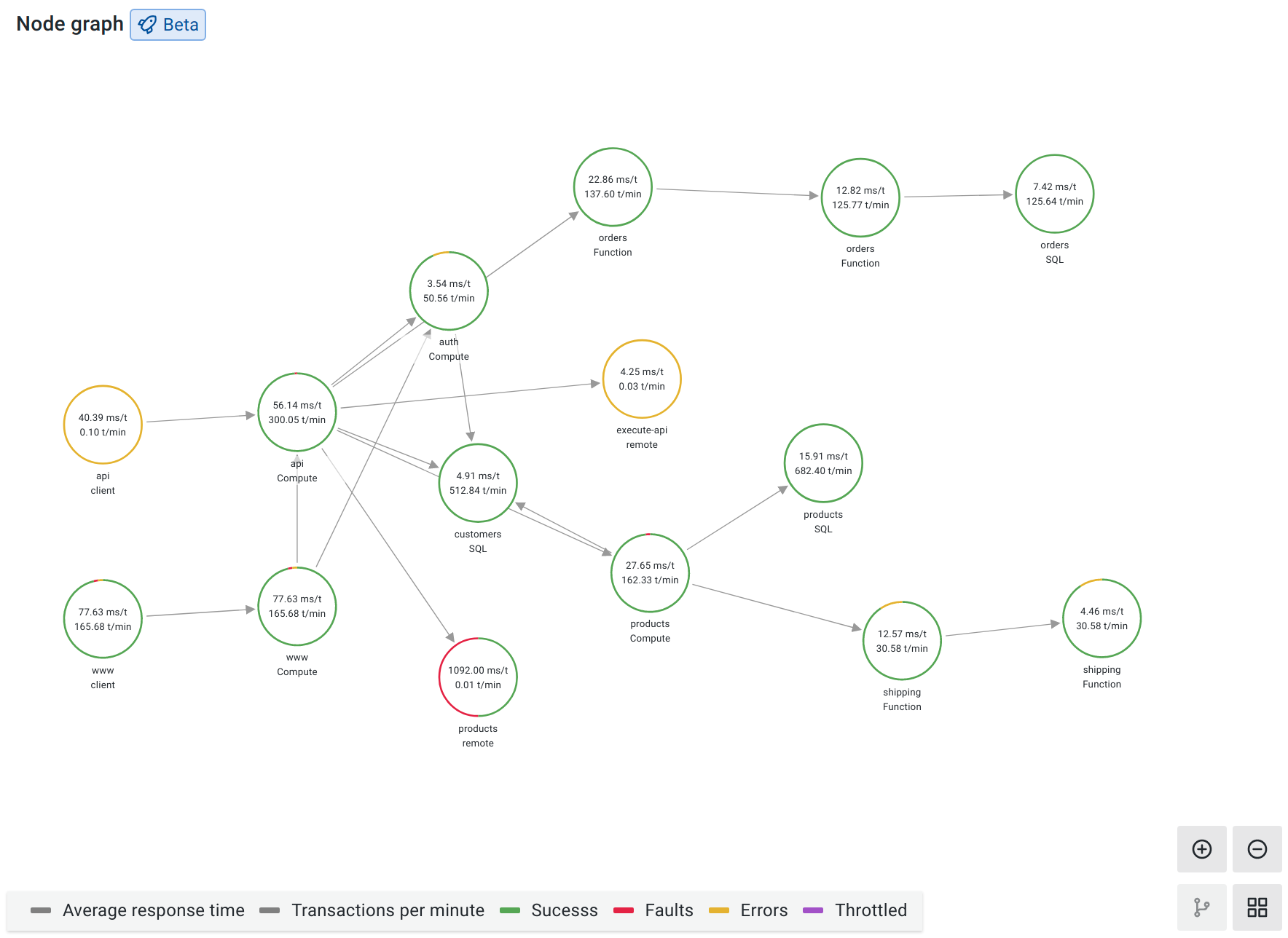

The Node graph can visualize directed graphs or networks. It uses a directed force layout to effectively position the nodes, so it can display complex infrastructure maps, hierarchies, or execution diagrams.

The Node graph visualization consists of nodes and edges.
- A node is displayed as a circle. A node might represent an application, a service, or anything else that is relevant from an application perspective.
- An edge is displayed as a line that connects two nodes. The connection might be a request, an execution, or some other relationship between the two nodes.

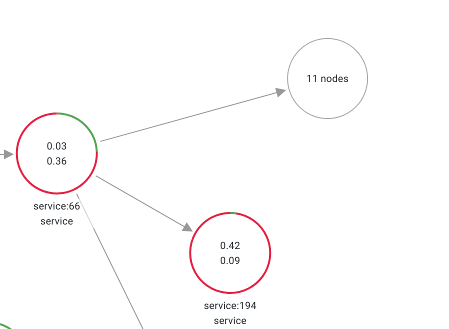

Note: Node graph can show only 1,500 nodes. If this limit is crossed a warning will be visible in upper right corner, and some nodes will be hidden. You can expand hidden parts of the graph by clicking on the “Hidden nodes” markers in the graph.

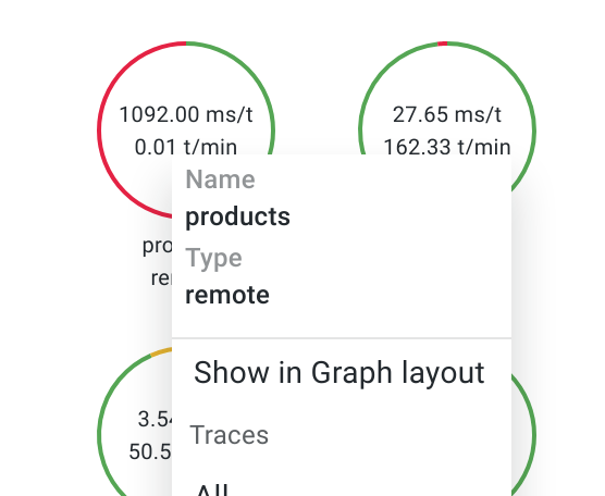

For example, you can have the percentage of errors represented by a red portion of the circle. Additional details can be displayed in a context menu which is displayed when you click on the node. There also can be additional links in the context menu that can target either other parts of Grafana or any external link.

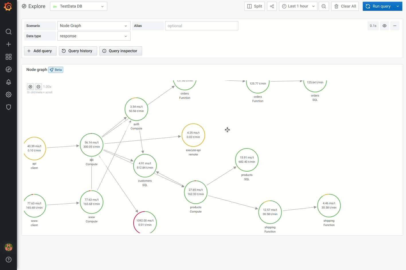

You can pan and zoom in or out the node graph.
Pan
You can pan the view by clicking outside any node or edge and dragging your mouse.
Zoom in or out
Use the buttons in the upper left corner or use the mouse wheel, touchpad scroll, together with either Ctrl or Cmd key to zoom in or out.
Explore hidden nodes
The number of nodes shown at a given time is limited to maintain a reasonable visualization performance. Nodes that are not currently visible are hidden behind clickable markers that show an approximate number of hidden nodes that are connected by a particular edge. You can click on the marker to expand the graph around that node.

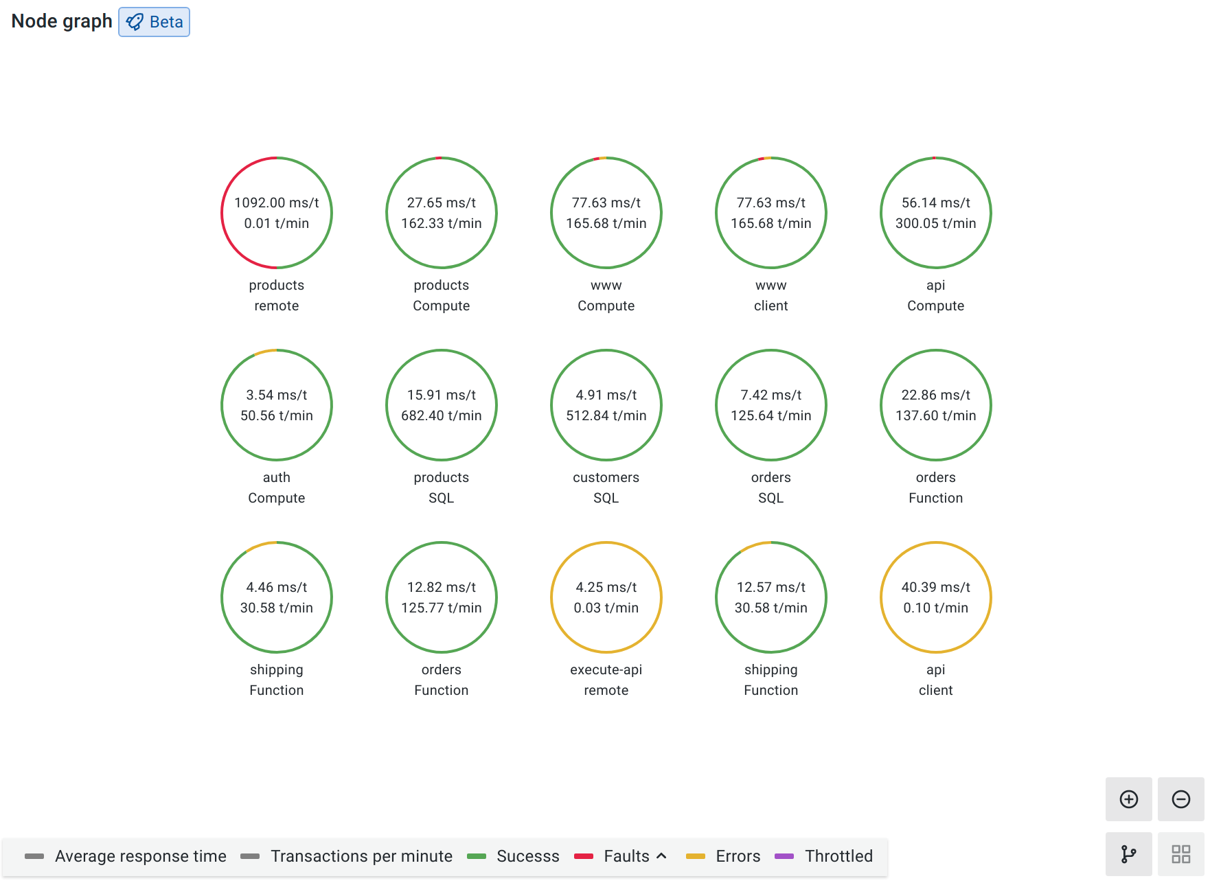

Grid view
You can switch to the grid view to have a better overview of the most interesting nodes in the graph. Grid view shows nodes in a grid without edges and can be sorted by stats shown inside the node or by stats represented by the a colored border of the nodes.
To sort the nodes, click on the stats inside the legend. The marker next to the stat name shows which stat is currently used for sorting and sorting direction.
Click on the node and select “Show in Graph layout” option to switch back to graph layout and focus on the selected node, to show it in context of the full graph.
