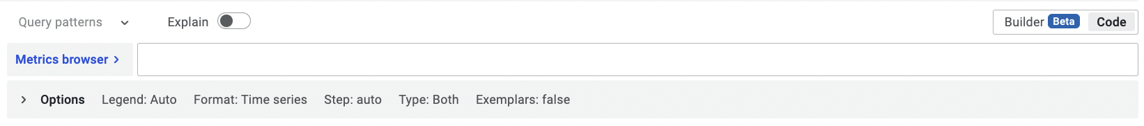

Code mode
Code mode allows you to write raw queries in a textual editor. It implements advanced autocomplete features and syntax highlighting to help with writing complex queries. In addition, it also contains Metrics browser to further aid with writing queries (see more docs below).

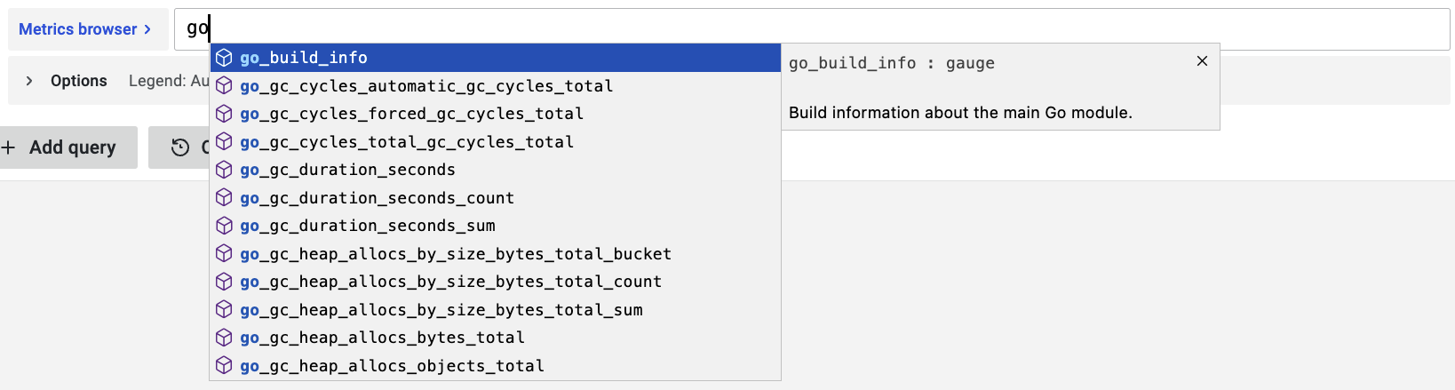

Autocomplete
Autocomplete kicks automatically in appropriate times during typing. Use ctrl/cmd + space to trigger autocomplete manually when needed. Autocomplete can suggest both static functions, aggregations and keywords but also dynamic items like metrics and labels. Autocomplete dropdown also shows documentation for the suggested items, either static one or dynamic metric documentation where available.

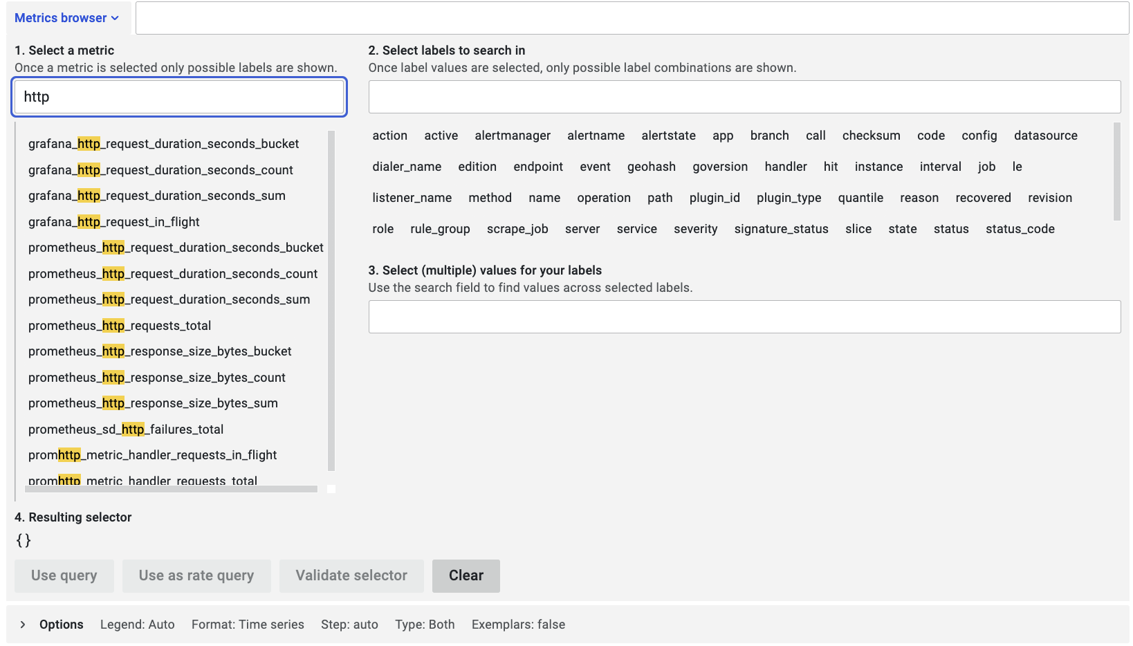

Metrics browser
The metrics browser allows you to quickly find metrics and select relevant labels to build basic queries. When you open the browser you will see all available metrics and labels. If supported by your Prometheus instance, each metric will show its HELP and TYPE as a tooltip.
When you select a metric, the browser narrows down the available labels to show only the ones applicable to the metric. You can then select one or more labels for which the available label values are shown in lists in the bottom section. Select one or more values for each label to tighten your query scope.
Note: If you do not remember a metric name to start with, you can also select a few labels first, to narrow down the list and then find relevant label values.
All lists in the metrics browser have a search field above them to quickly filter for metrics or labels that match a certain string. The values section only has one search field. It’s filtering applies to all labels to help you find values across labels once they have been selected, for example, among your labels app, job, job_name only one might with the value you are looking for.
Once you are satisfied with your query, click “Use query” to run the query. The button “Use as rate query” adds a rate(...)[$__interval] around your query to help write queries for counter metrics.
The “Validate selector” button will check with Prometheus how many time series are available for that selector.

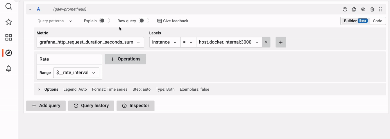

Use the + Operations button to add operation to your query. Operations are grouped into sections for easier navigation. When the operations dropdown is open, write into the search input to search and filter operations list.
Operations in a query are shown as boxes in the operations section. Each has a header with a name and additional action buttons. Hover over the operation header to show the action buttons. Click the v button to quickly replace the operation with different one of the same type. Click the info button to open operations’ description tooltip. Click the x button to remove the operation.
Operation can have additional parameters under the operation header. See the operation description or Prometheus docs for more details about each operation.
Some operations make sense only in specific order, if adding an operation would result in nonsensical query, operation will be added to the correct place. To order operations manually drag operation box by the operation name and drop in appropriate place.

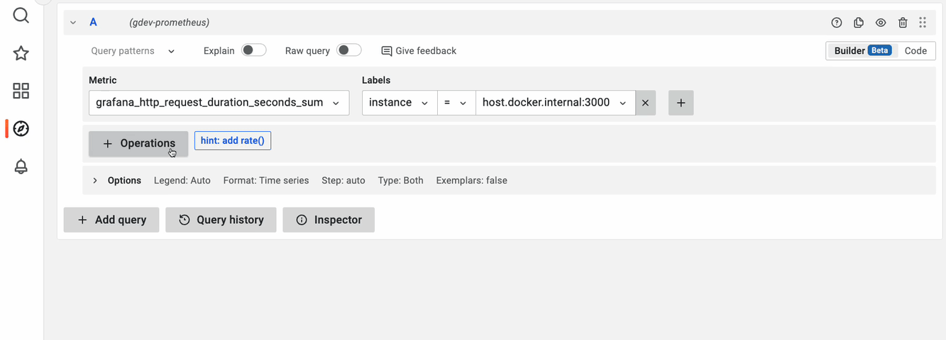

Hints
In same cases the query editor can detect which operations would be most appropriate for a selected metric. In such cases it will show a hint next to the + Operations button. Click on the hint to add the operations to your query.

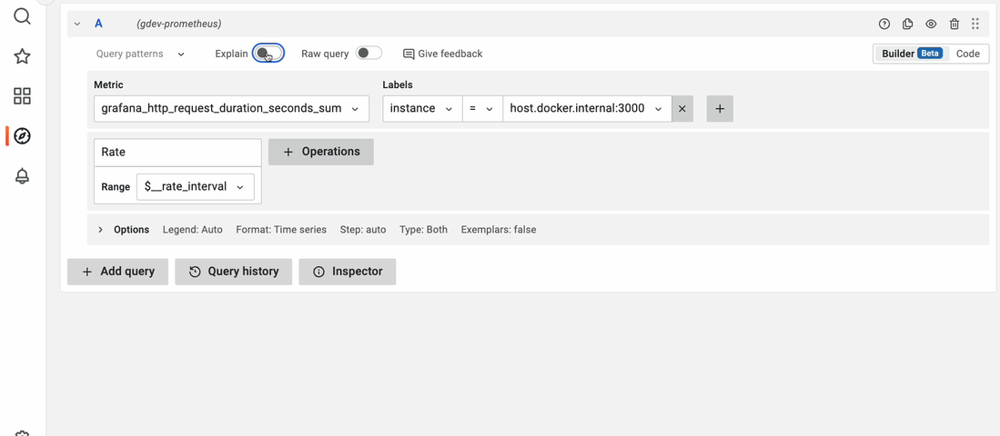

Explain
Explain mode helps with understanding the query. It shows a step by step explanation of all query parts and the operations.
