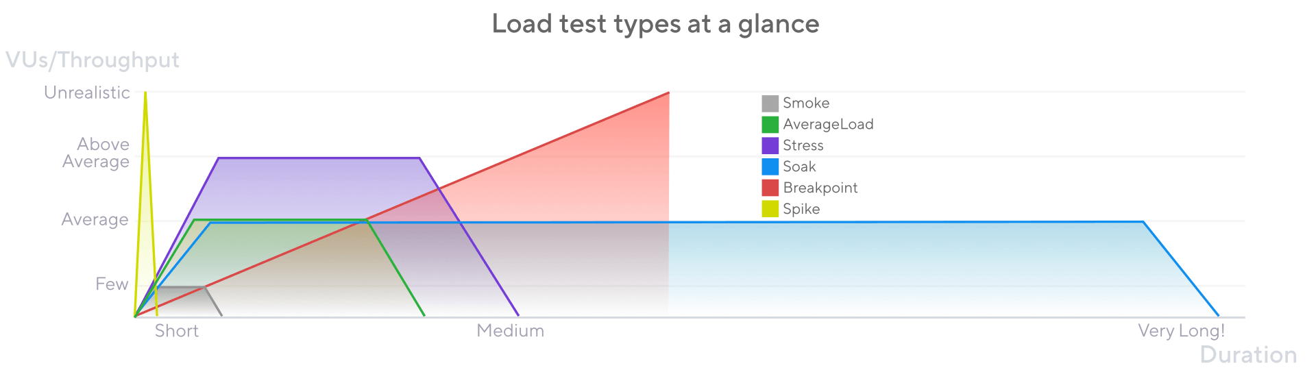

Many things can go wrong when a system is under load. The system must run numerous operations simultaneously and respond to different requests from a variable number of users. To prepare for these performance risks, teams use load testing.
But a good load-testing strategy requires more than just executing a single script. Different patterns of traffic create different risk profiles for the application. For comprehensive preparation, teams must test the system against different test types.
Overview of load test shapes
Different tests for different goals
Start with smoke tests, then progress to higher loads and longer durations.
The main types are as follows. Each type has its own article outlining its essential concepts.
  • Smoke tests validate that your script works and that the system performs adequately under minimal load.
  • Average-load test assess how your system performs under expected normal conditions.
  • Stress tests assess how a system performs at its limits when load exceeds the expected average.
  • Soak tests assess the reliability and performance of your system over extended periods.
  • Spike tests validate the behavior and survival of your system in cases of sudden, short, and massive increases in activity.
  • Breakpoint tests gradually increase load to identify the capacity limits of the system.

Test-type cheat sheet
The following table provides some broad comparisons.
TypeVUs/ThroughputDurationWhen?
SmokeLowShort (seconds or minutes)When the relevant system or application code changes. It checks functional logic, baseline metrics, and deviations
LoadAverage productionMid (5-60 minutes)Often to check system maintains performance with average use
StressHigh (above average)Mid (5-60 minutes)When system may receive above-average loads to check how it manages
SoakAverageLong (hours)After changes to check system under prolonged continuous use
SpikeVery highShort (a few minutes)When the system prepares for seasonal events or receives frequent traffic peaks
BreakpointIncreases until breakAs long as necessaryA few times to find the upper limits of the system

Aim for simple designs and reproducible results
While the specifics are greatly context-dependent, what’s constant is that you want to make results that you can compare and interpret.
Stick to simple load patterns. For all test types, directions is enough: ramp-up, plateau, ramp-down.
Avoid “rollercoaster” series where load increases and decreases multiple times. These will waste resources and make it hard to isolate issues.
