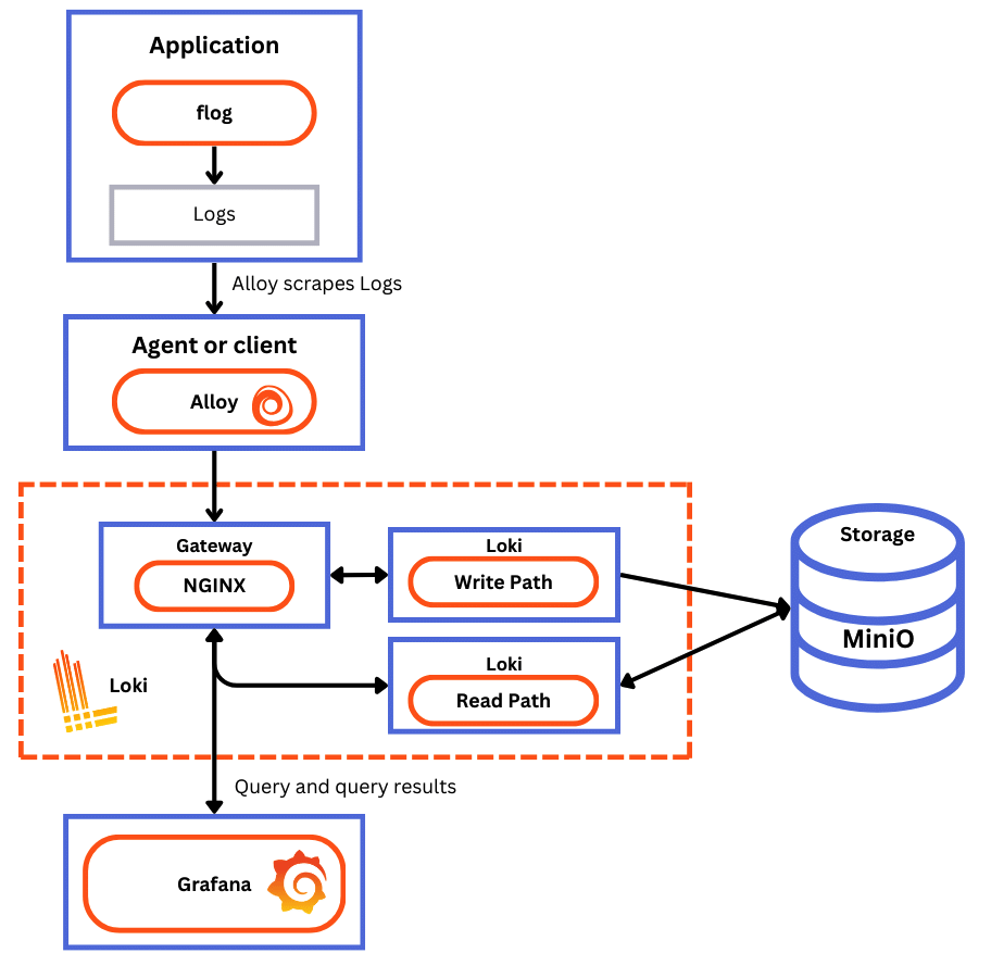

If you want to experiment with Loki, you can run Loki locally using the Docker Compose file that ships with Loki. It runs Loki in a monolithic deployment mode and includes a sample application to generate logs.
The Docker Compose configuration runs the following components, each in its own container:
flog: which generates log lines. flog is a log generator for common log formats.
Grafana Alloy: which scrapes the log lines from flog, and pushes them to Loki through the gateway.
Gateway (nginx) which receives requests and redirects them to the appropriate container based on the request’s URL.
Loki read component: which runs a Query Frontend and a Querier.
Loki write component: which runs a Distributor and an Ingester.
Loki backend component: which runs an Index Gateway, Compactor, Ruler, Bloom Compactor (experimental), and Bloom Gateway (experimental).
Minio: which Loki uses to store its index and chunks.
Grafana: which provides visualization of the log lines captured within Loki.

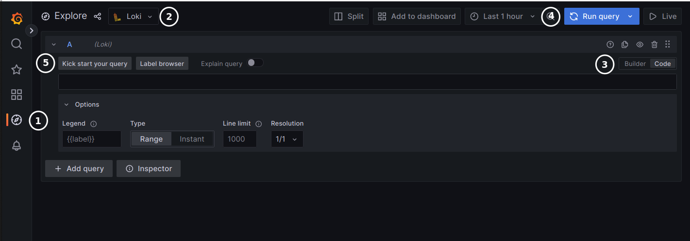

![Grafana Explore Grafana Explore]()
Grafana Explore From the Grafana main menu, click the Explore icon (1) to open the Explore tab.
To learn more about Explore, refer to the Explore documentation.
From the menu in the dashboard header, select the Loki data source (2).
This displays the Loki query editor.
In the query editor you use the Loki query language, LogQL, to query your logs. To learn more about the query editor, refer to the query editor documentation.
The Loki query editor has two modes (3):
- Builder mode, which provides a visual query designer.
- Code mode, which provides a feature-rich editor for writing LogQL queries.
Next we’ll walk through a few simple queries using both the builder and code views.
Click Code (3) to work in Code mode in the query editor.
Here are some sample queries to get you started using LogQL. These queries assume that you followed the instructions to create a directory called
evaluate-loki.If you installed in a different directory, you’ll need to modify these queries to match your installation directory.
After copying any of these queries into the query editor, click Run Query (4) to execute the query.
