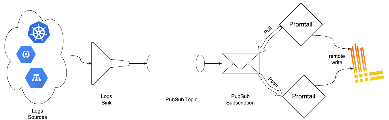

Overall, the setup between GCP, Promtail and Loki will look like the following:
