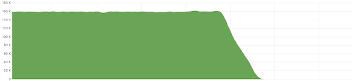

To disable write requests, configure the following flag on the distributor and the ruler:
-ingester.ring.excluded-zones=zone-aBefore proceeding to the next step, use the following query to ensure that there are no write requests to the ingesters from zone-a:
sum by(route) (
rate(
cortex_request_duration_seconds_count{
namespace="<your-namespace>",
container="ingester",
pod=~"ingester-zone-a-.*",
route="/cortex.Ingester/Push"}[5m]
)You should see something like this:
Step 2: Shut down ingesters from zone-a

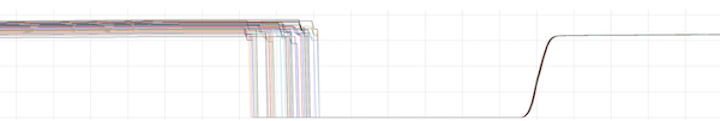

-ingester.ring.spread-minimizing-join-ring-in-order=trueStep 4: Re-enable write requests to ingesters from zone-a
To re-enable write requests, revert link Step 1: Disable write requests to ingesters from zone-a.
At this point, you can check the number of in-memory time series of ingesters from zone-a using the following query:
sum by(pod) (
cortex_ingester_memory_series{
pod=~"ingester-zone-a-.*"}
)If everything went smoothly, you should see something like this:
