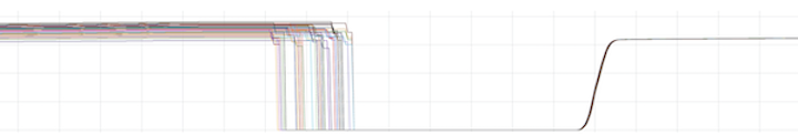

-ingester.ring.excluded-zones=zone-aBefore proceeding to the next step, use the following query to ensure that there are no write requests to the ingesters from zone-a:
sum by(route) (
rate(
cortex_request_duration_seconds_count{
namespace="<your-namespace>",
container="ingester",
pod=~"ingester-zone-a-.*",
route="/cortex.Ingester/Push"}[5m]
)You should see something like this:

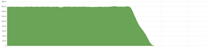

At this point, you can check the number of in-memory time series of ingesters from zone-a using the following query:
sum by(pod) (
cortex_ingester_memory_series{
pod=~"ingester-zone-a-.*"}
)If everything went smoothly, you should see something like this:
