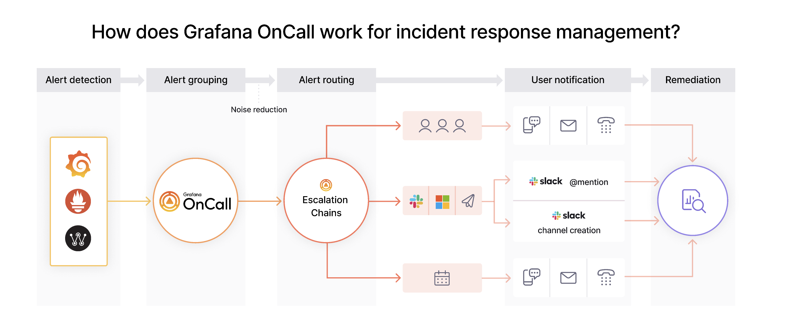

The following diagram details an example alert workflow with Grafana OnCall:
