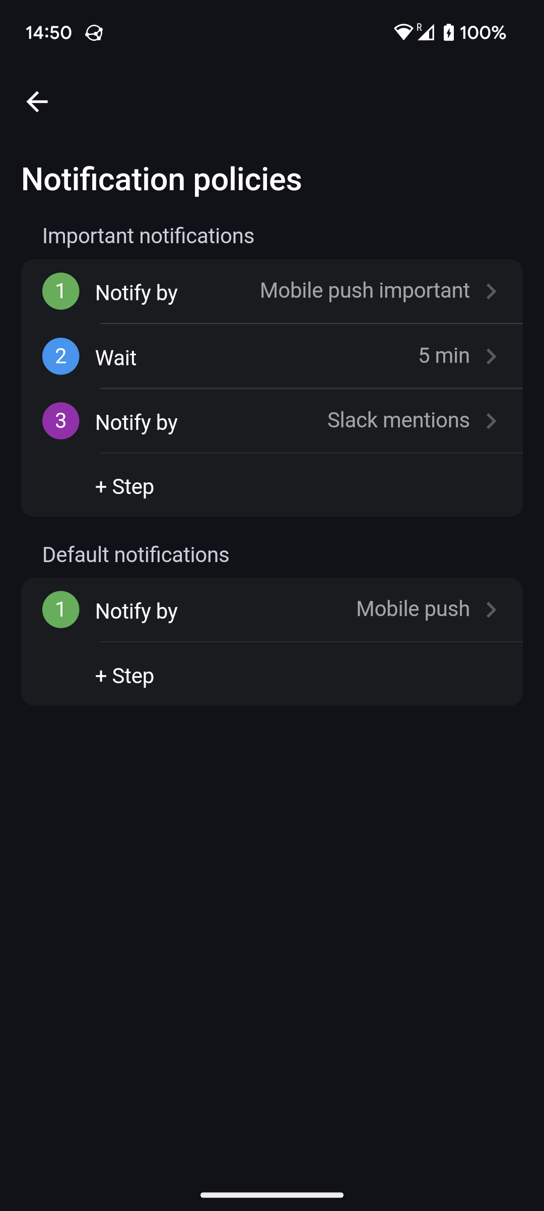

Add mobile app to notification policies
To receive push notifications from the Grafana OnCall mobile app, you must add them to your notification policy steps. Important notifications should include Mobile push important and Default notifications should include Mobile push.

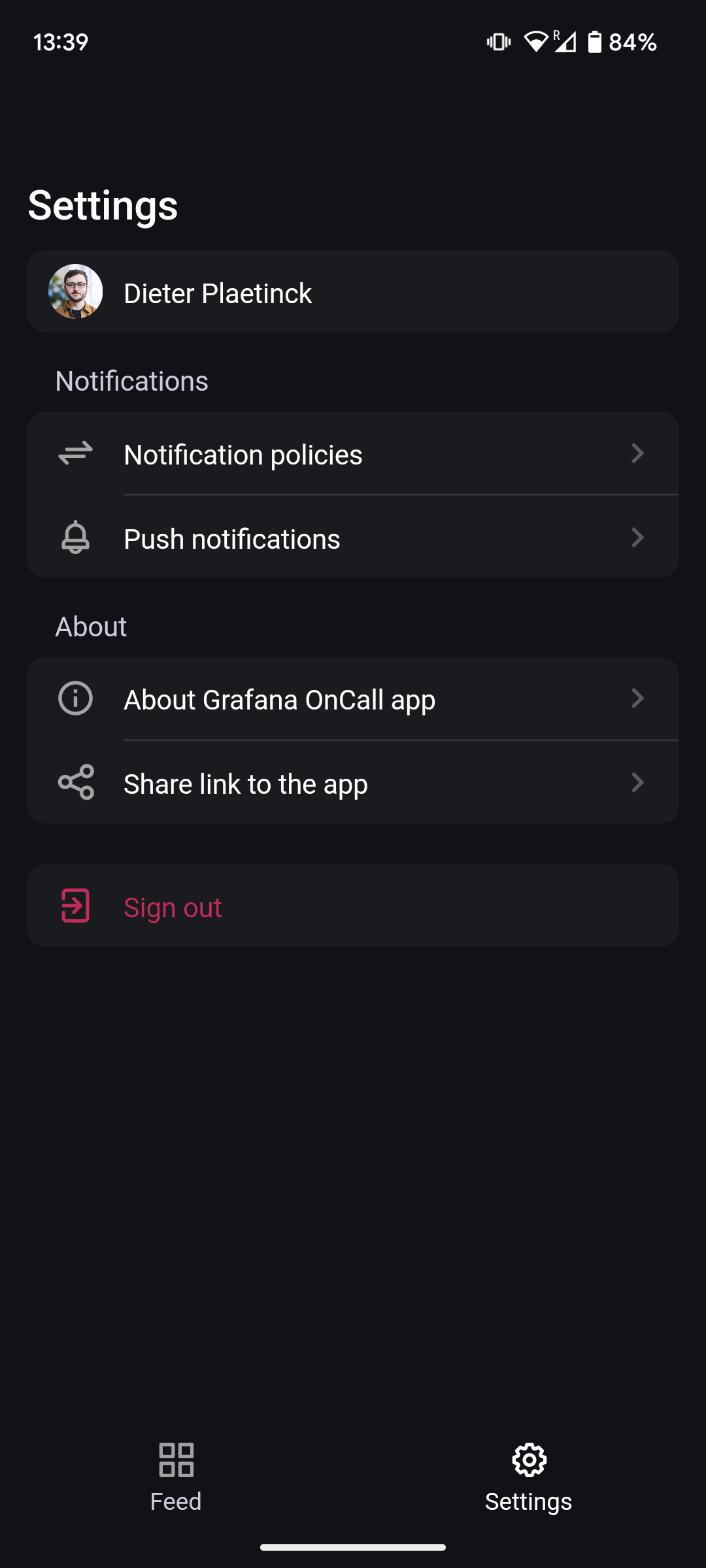

In the Settings tab of the mobile app, tap on Notification policies to review, reorder, remove, add or change steps.

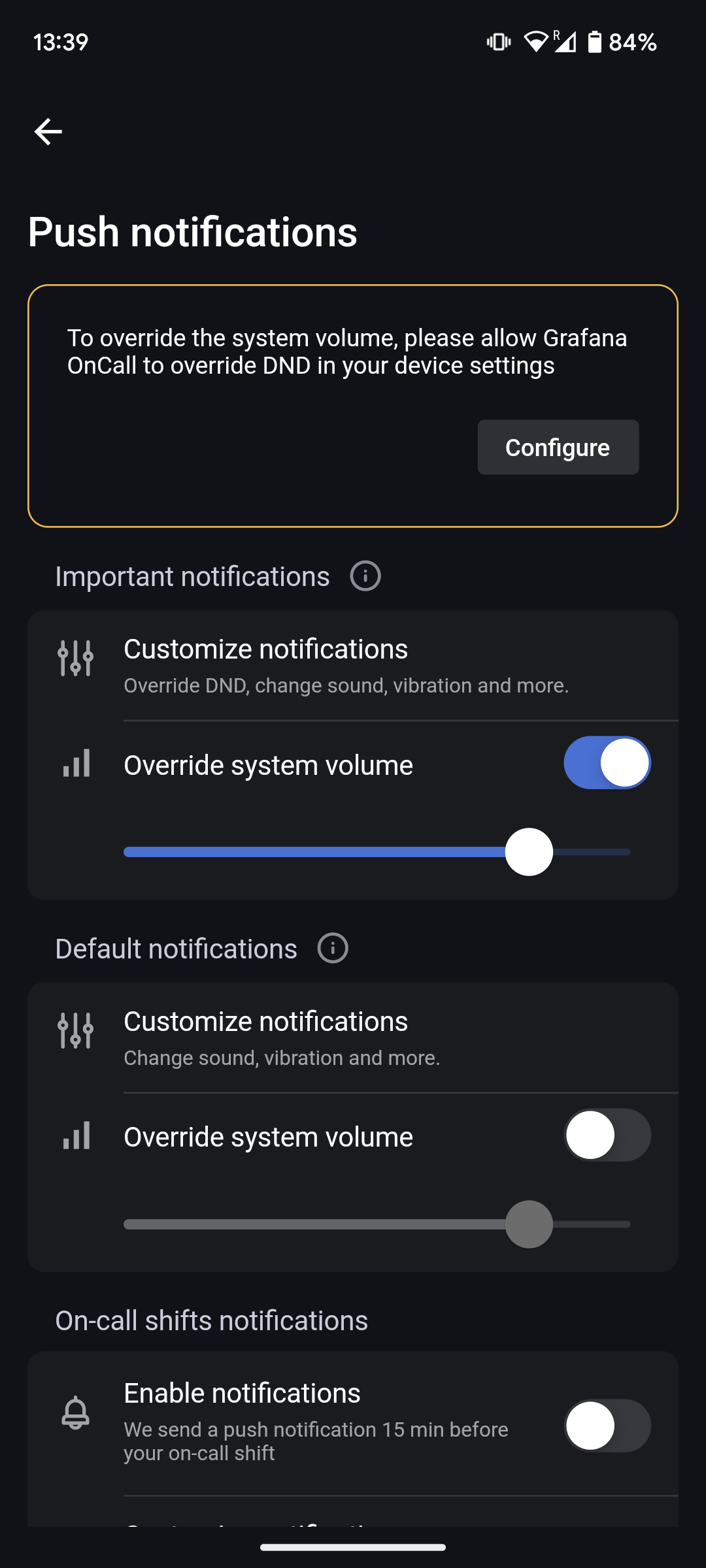

Use the Push notifications section in the Settings tab to configure push notifications.

Android

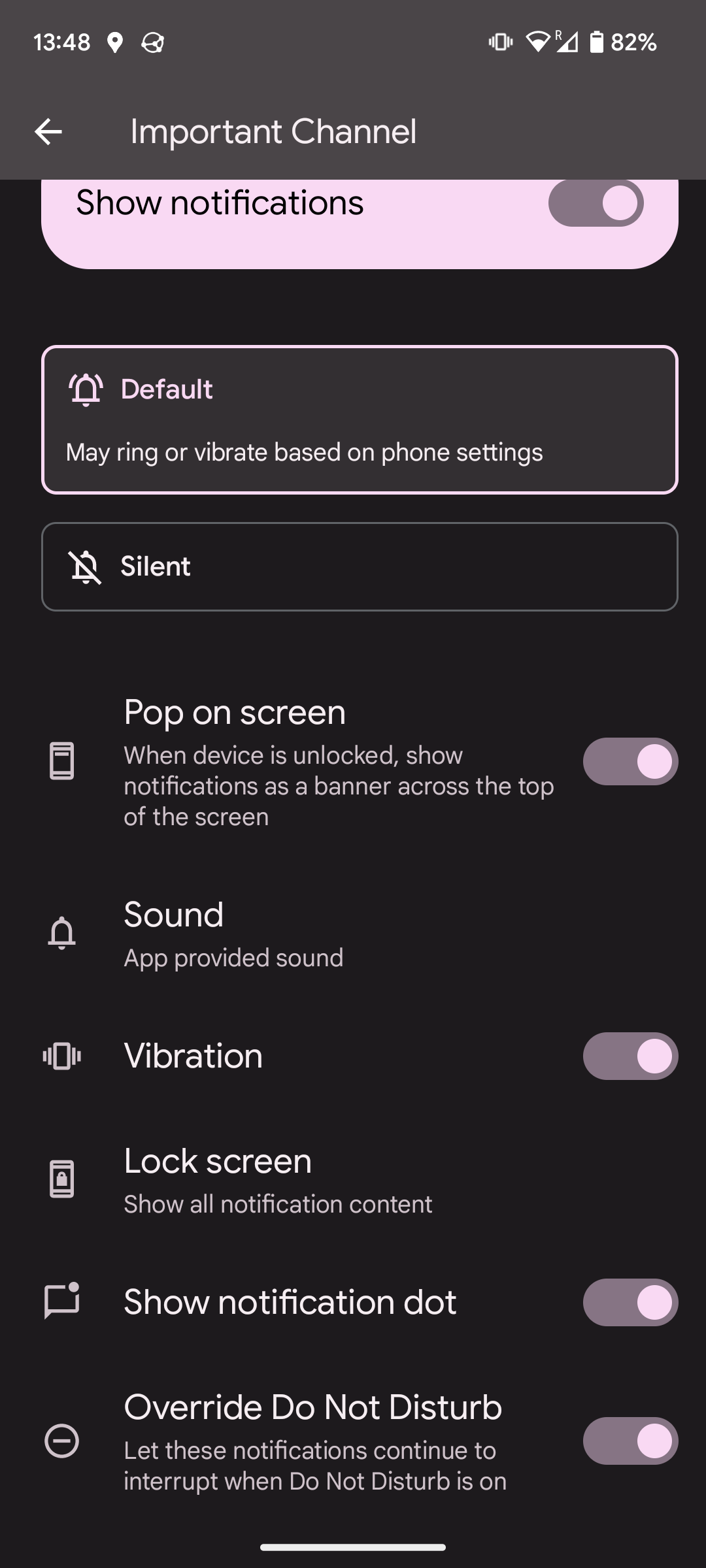

On Android, we leverage the “Notification channels” system feature. Each type of notification (important, default, and on-call shifts) registers a channel. In this channel, you may configure the sound style, vibration, and so on. Customize notifications takes you to this system menu, while hitting the back button or swiping left (if enabled) takes you back to the application.

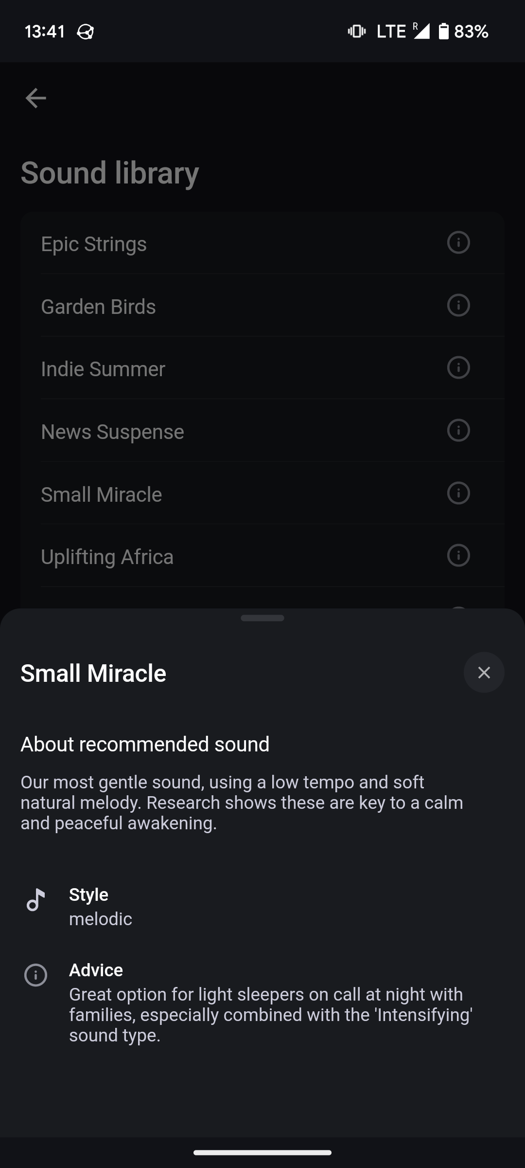

Note: You can explore included sounds and recommendations via the Sound Library button, but to change the sound, go to Customize notifications.
Override Do Not Disturb
  • On most Android versions, the Override Do Not Disturb option is available in the channel options described above.
  • On some Samsung devices, you can add the Grafana Oncall app under (System) Settings > Notifications > Do not disturb > App notifications.
  • If your device does something different, you may need to search for this setting for notifications via the (System) Settings app. Do not confuse this with the Override Do Not Disturb application permission, needed for Volume Overrides (see below).
Override Volume
Volume Override can optionally be configured in the mobile app itself. Confusingly, this requires you to provide the Override Do Not Disturb permission to the application, in the system configuration. The app will prompt for this if applicable. Note that this is a different setting than the Do Not Disturb override needed for notifications triggered by the application, which is described above.

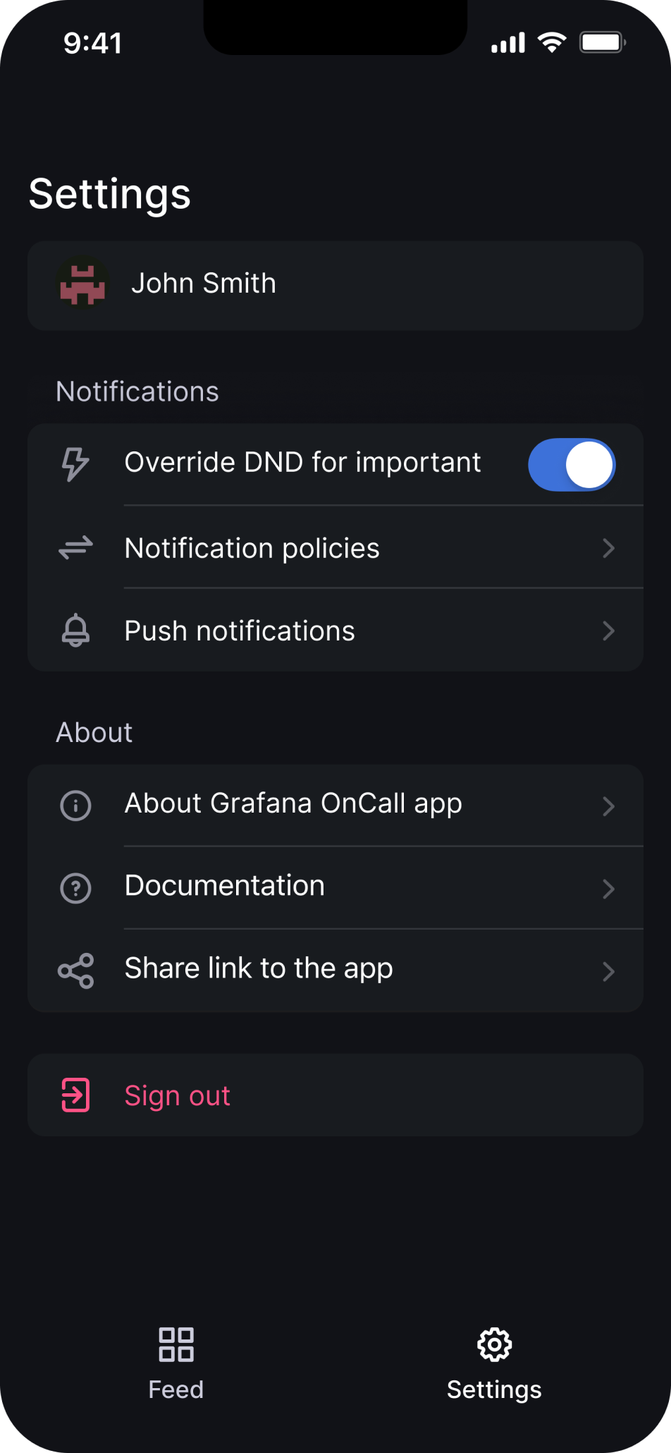

On iOS, all configuration (such as sound selection, Do Not Disturb override, etc) happens inside the app.

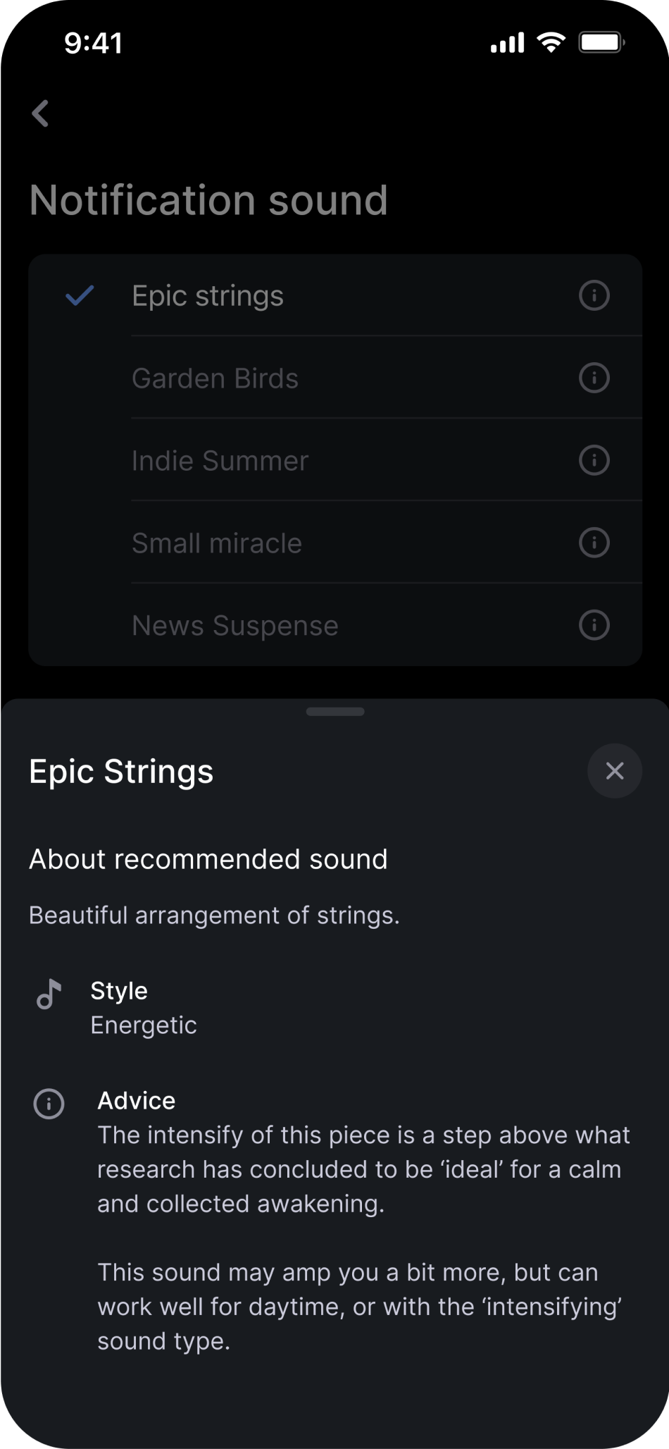

For every type of notification (important, default, and on-call shifts), you can configure the sound and its style (constant vs intensifying).
You can also enable or disable Do Not Disturb override for important notifications.
