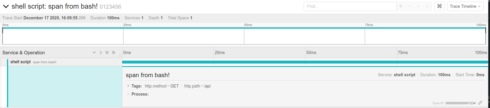

Retrieving Traces
The easiest way to get the trace is to execute a simple curl command to Tempo. The returned format is OTLP.
curl http://localhost:3200/api/traces/0123456789abcdef
{"batches":[{"resource":{"attributes":[{"key":"service.name","value":{"stringValue":"shell script"}}]},"instrumentationLibrarySpans":[{"spans":[{"traceId":"AAAAAAAAAAABI0VniavN7w==","spanId":"AAAAAAAAEjQ=","name":"span from bash!","startTimeUnixNano":"1608239395286533000","endTimeUnixNano":"1608239395386533000","attributes":[{"key":"http.path","value":{"stringValue":"/api"}},{"key":"http.method","value":{"stringValue":"GET"}}]}]}]}]}However, staring at a json blob in bash is not very fun. Let’s start up Tempo query so we can visualize our trace. Tempo query is Jaeger Query with a GRPC Plugin that allows it to query Tempo.
docker run --env BACKEND=localhost:3200 --net host grafana/tempo-query:latestAnd open http://localhost:16686/trace/0123456789abcdef in the browser of your choice to see:

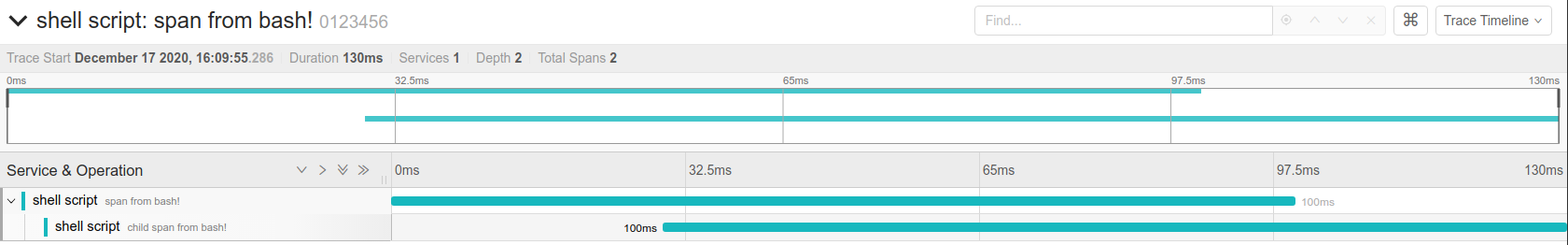

Now that we have the basics down it’s easy to continue building our trace. By specifying the same trace id and a parent span id we can start building a trace.
curl -X POST http://localhost:9411 -H 'Content-Type: application/json' -d '[{
"id": "5678",
"traceId": "0123456789abcdef",
"parentId": "1234",
"timestamp": 1608239395316533,
"duration": 100000,
"name": "child span from bash!",
"localEndpoint": {
"serviceName": "shell script"
}]'And now the UI shows:
