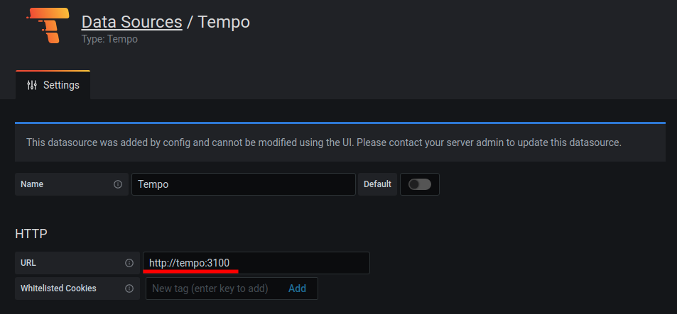

Grafana 7.5.x and higher (easy mode)
Grafana 7.5.x and higher can query Tempo directly. Point the Grafana data source at your Tempo query frontend (or single
binary) and enter the URL: http://<tempo hostname>:<http port number>. For most of our examples the following works.
Note that the port of 3200 is a common port used in our examples. Tempo default for http is 80.
Grafana 7.4.x
Grafana 7.4.x is not able to query Tempo directly and requires the tempo-query component as an intermediary. In this case you need to run Tempo-Query and direct it at Tempo proper. Check out the Grafana 7.4.x example to help with configuration.
The url entered will be http://<tempo-query hostname>:16686/.
