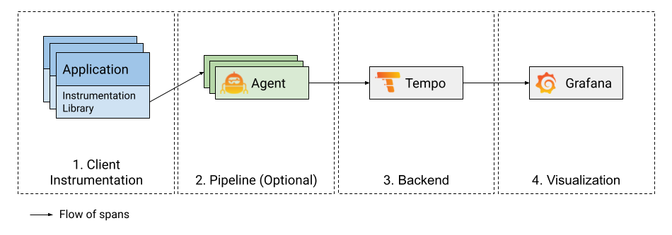

Distributed tracing visualizes the lifecycle of a request as it passes through a set of applications. There are a few components that must be configured in order to get a working distributed tracing visualization.
This document discusses the four major pieces necessary to build out a tracing system: Instrumentation, Pipeline, Backend and Visualization. If one were to build a diagram laying out these pieces it may look something like this:

1. Instrumentation
Instrumentation SDKs
The first building block to a functioning distributed tracing visualization pipeline is client instrumentation, which is the process of adding instrumentation points in the application that creates and offloads spans.

2. Pipeline (Grafana Agent)
Once your application is instrumented for tracing, the next step is to send these traces to a backend for storage and visualization. It is common to build a tracing pipeline that offloads spans from your application, buffers them and eventually forwards them to a backend. Tracing pipelines are optional (most clients can send directly to Tempo), but you will find that they become more critical the larger and more robust your tracing system is.
The Grafana Agent is a service that is deployed close to the application, either on the same node or within the same cluster (in kubernetes) to quickly offload traces from the application and forward them to a storage backend. It also abstracts features like trace batching and backend routing away from the client.

3. Backend (Tempo)
Grafana Tempo is an easy-to-use and high-scale distributed tracing backend used to store and query traces. The purpose of the tracing backend is to store and retrieve traces on demand.

4. Visualization (Grafana)
Grafana has a built in Tempo datasource that can be used to query Tempo and visualize traces. For more information refer to the Tempo data source, and the Tempo in Grafana topics.
