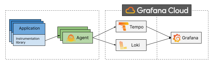

Running distributed tracing systems is very powerful, but it brings its own challenges, and one of them is trace discovery. Tempo supports finding a trace if you know the trace identifier, so we leverage other tools like logs and metrics to discover traces.
Automatic logging provides an easy and fast way of getting trace discovery through logs. Automatic logging writes a well formatted log line to a Loki instance or to stdout for each span, root or process that passes through the tracing pipeline. This allows for automatically building a mechanism for trace discovery. On top of that, we also get metrics from traces using Loki.
