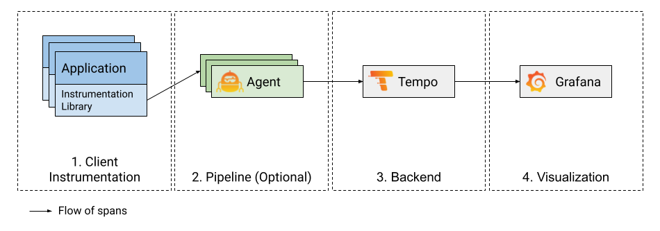

To build a tracing pipeline, you need four major components: client instrumentation, pipeline, backend, and visualization.
This diagram illustrates a tracing system configuration:
Tracing pipeline overview
Client instrumentation
Client instrumentation (1 in the diagram) is the first building block to a functioning distributed tracing visualization pipeline. Client instrumentation is the process of adding instrumentation points in the application that create and offload spans.

Pipeline (Grafana Agent)
Once your application is instrumented for tracing, the traces need to be sent to a backend for storage and visualization. You can build a tracing pipeline that offloads spans from your application, buffers them, and eventually forwards them to a backend. Tracing pipelines are optional (most clients can send directly to Tempo), but the pipelines become more critical the larger and more robust your tracing system is.
The Grafana Agent is a service that is deployed close to the application, either on the same node or within the same cluster (in Kubernetes) to quickly offload traces from the application and forward them to a storage backend. The Grafana Agent also abstracts features like trace batching to a remote trace backend store, including retries on write failures.

Backend (Tempo)
Grafana Tempo is an easy-to-use and high-scale distributed tracing backend used to store and query traces. The tracing backend stores and retrieves traces on demand.

Visualization (Grafana)
Grafana has a built-in Tempo data source that can be used to query Tempo and visualize traces. For more information, refer to the Tempo data source and the Tempo in Grafana topics.
