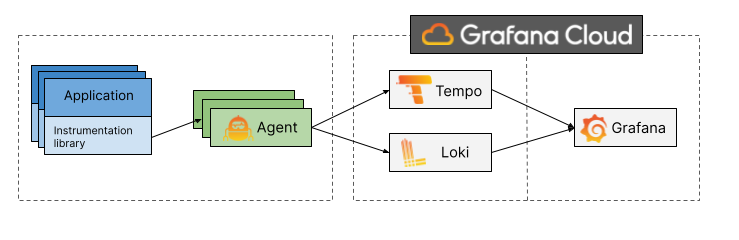

Automatic logging provides an easy and fast way of discovering trace IDs
through log messages. Well-formatted log lines are written to a Loki instance
or to stdout for each span, root, or process that passes through the tracing
pipeline. This allows for automatically building a mechanism for trace
discovery. On top of that, we also get metrics from traces using Loki, and
allow quickly jumping from a log message to the trace view in Grafana.
