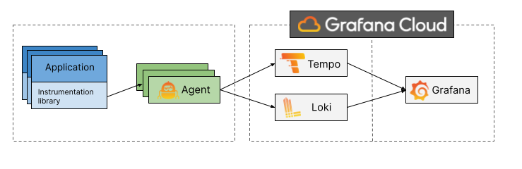

Automatic logging overview
Automatic logging searches for a given set of attributes in the spans and logs them as key-value pairs. This allows searching by those key-value pairs in Loki.
