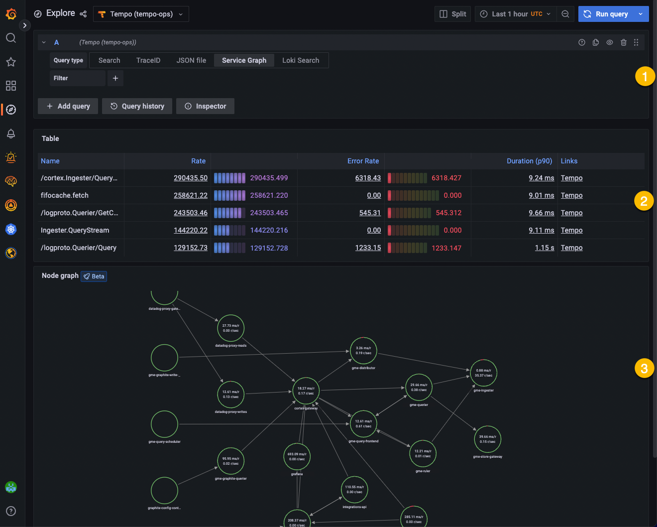

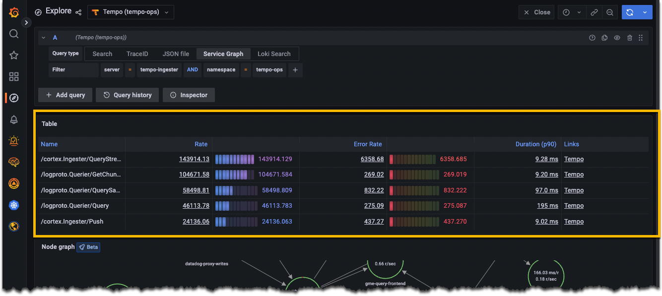

The service graph view provides a span metrics visualization (table, screen section 2) and service graph (screen section 3). In addition, you can use the filters (screen section 1) to customize the data displayed.
Any information in the table that has an underline can be selected to show more detailed information.
You can also select any node in the service graph to display additional information.

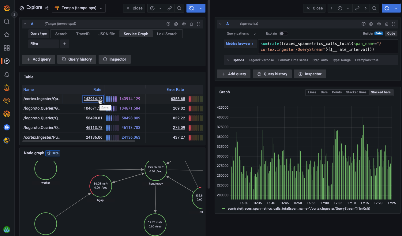

In the dashboard shown below, the Ingester.QueryStream span has a request rate of 144220.22 requests per second.
The /cortex.Ingester/Query span has the highest request rate.

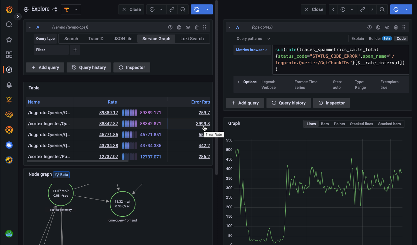

Error rate example

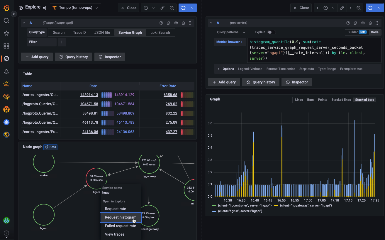

Let’s say we want to learn more about why cortex.Ingester has the highest error rates.

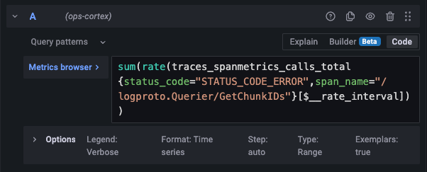

Selecting the second row of the Error rate column displays details about the span metrics in a new window on the right side.
The metrics query used to generate the data appears in the Metrics browser field.

The span metrics table contains seven columns with five column headings. Selecting a heading sorts the data by ascending or descending values.

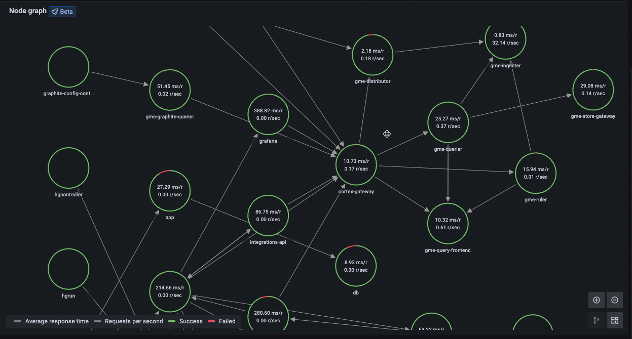

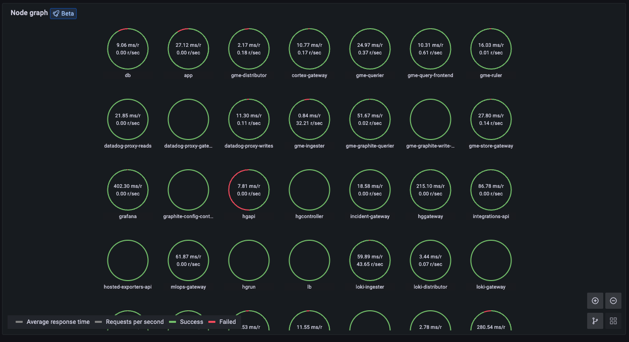

Service graphs
A service graph (node graph) is a visual representation of the interrelationships between various services. Service graphs help to understand the structure of a distributed system, and the connections and dependencies between its components.
Service graphs infer the topology of a distributed system, provide a high level overview of the health of your system, and a historic view of a system’s topology. Service graphs show error rates and latencies, among other relevant data. The service graph layout can be the default or grid.
The grid layout changes the service graph to a series of rows and columns.
If you are using the metrics-generator, then it processes traces and generates service graphs in the form of time series metrics like:
traces_service_graph_request_total{client="app", server="db"} 20For information about service graphs and how they are calculated, refer to the Service Graphs documentation.

In the table, you can select items in the Rate, Error Rate, Duration (p90), and Links columns. Choosing one of these items provides details about the span metrics.
You can view request rate, request histogram, failed request rate, and traces for any node in the service graph. To view more information, select the node in the service graph and then choose an option from the popup. For details on navigating the service graph, refer to the Node graph panel documentation.

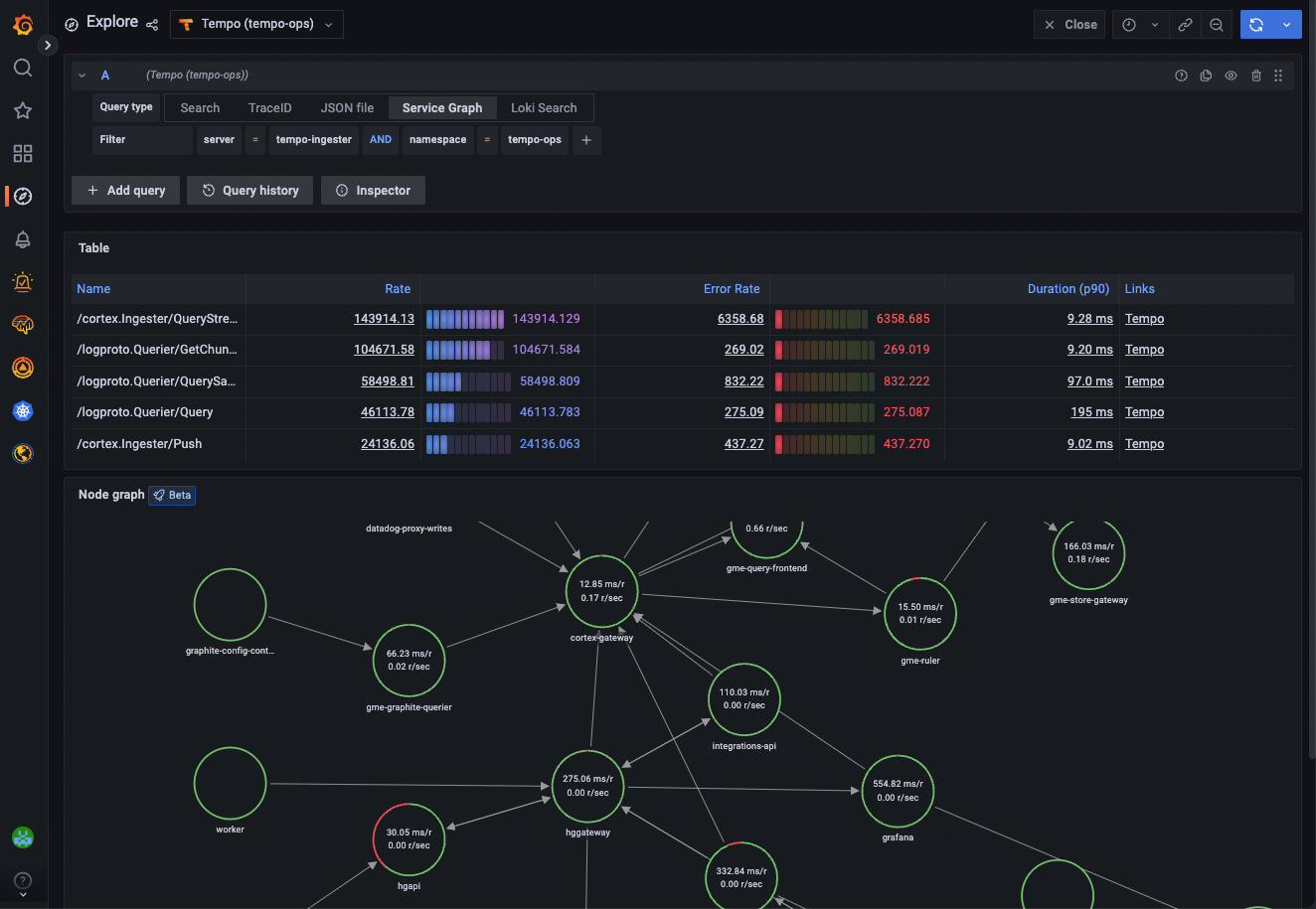

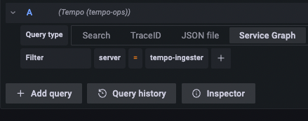

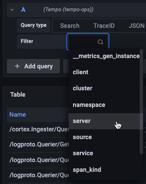

At the top of the Service Graph, select the text box after Filter to display a list of available labels. In this case, server is selected.
Select or search for a value for the label. In this case, the value of server is equal to tempo-ingester. The default operator is equals (=).

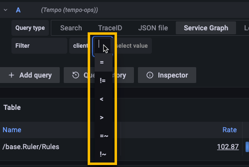

Optional: Change the operator by selecting = and choosing a new option from the drop-down.

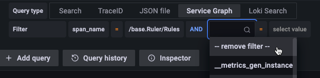

Optional: Add additional key-value pairs to refine the data set. Any subsequent label filters use AND, which requires both key-value pairs to be presents for matches.
Select Run query.
Filters can be removed by selecting the filter drop-down and choosing – remove filter –.

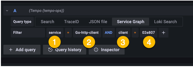

In the example below, each field or label represents a key-value pair. Number 1 selects a service as the label whose value is Go-http-client (2). The second key-value pair has a client as a label whose value is 02e807.

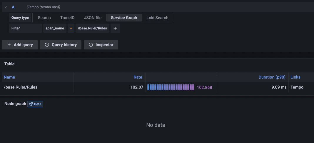

If your metrics queries are too specific, they may not return any results.
Updating the filter to be less specific returns a result. In this case, the results show only span metrics data associated with the span_name label with a value of /base.Ruler/Rules. No service graph data was available.
