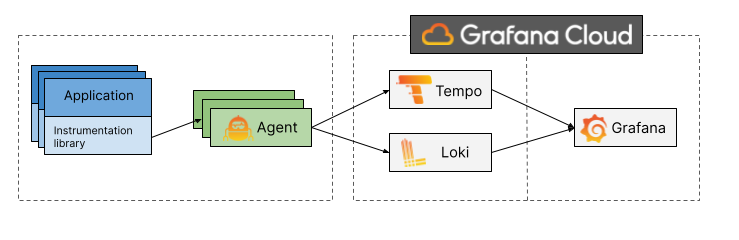

Automatic logging provides an easy and fast way of discovering trace IDs
through log messages. Well-formatted log lines are written to a Loki instance
or to stdout for each span, root, or process that passes through the tracing
pipeline. This allows for automatically building a mechanism for trace
discovery. On top of that, you can also get metrics from traces using Loki, and
allow quickly jumping from a log message to the trace view in Grafana.

This simple example logs trace roots to stdout and is a good way to get started using automatic logging:
traces:
configs:
- name: default
automatic_logging:
backend: stdout
roots: trueThis example pushes logs directly to a Loki instance also configured in the same Grafana Agent.
traces:
configs:
- name: default
automatic_logging:
backend: logs_instance
logs_instance_name: default
roots: trueExamples
