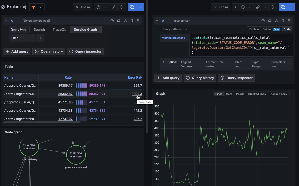

Error rate example
Let’s say we want to learn more about why cortex.Ingester has the highest error rates.

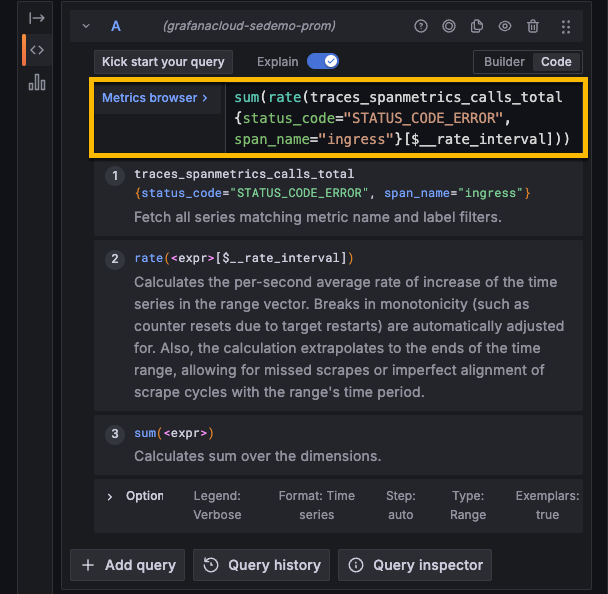

Selecting the second row of the Error rate column displays details about the span metrics in a new window on the right side.
The metrics query used to generate the data appears in the Metrics browser field.

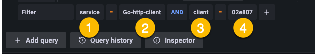

At the top of the Service Graph, select the text box after Filter to display a list of available labels.
Select or search for a value for the label. In this case, the value of server is equal to tempo-ingester. The default operator is equals (=).
Optional: Change the operator by selecting = and choosing a new option from the drop-down.
Optional: Add additional key-value pairs to refine the data set. Any subsequent label filters use AND, which requires both key-value pairs to be presents for matches.
Select Run query.
Filters can be removed by selecting the filter drop-down and choosing – remove filter –.
Each field or label represents a key-value pair. Number 1 selects a service as the label whose value is Go-http-client (2). The second key-value pair has a client as a label whose value is 02e807.

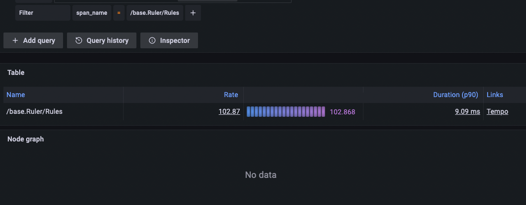

If your metrics queries are too specific, they may not return any results.
Updating the filter to be less specific returns a result. In this case, the results show only span metrics data associated with the span_name label with a value of /base.Ruler/Rules. No service graph data was available.
