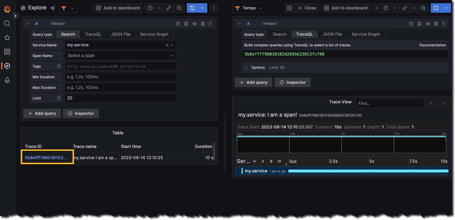

View the trace in Grafana:
- Open a browser window to http://localhost:3000.
- Open the Explorer page and select the Tempo data source.
- Select the Search query type.
- Select Run query to list available traces.
- Select the trace ID (yellow box) to view details about the trace and its spans.
