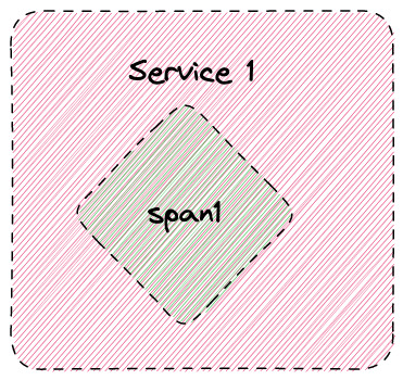

Let’s consider a span that’s emitted from some piece of code in a service:
Here’s a single service with a single span.
If the code inside the span never leaves the service, then the span_kind label generated by the metrics generator will be SPAN_KIND_INTERNAL and never deviate. It’ll never be one of the other four possible values.
Similarly, if the code inside the span never errors, it’ll only have the STATUS_CODE_OK state for the span_status label.
This means that the metrics generator will only generate a single active series, where the service name will be Service 1 and the span name will be span1.
If we looked at the Prometheus data for the traces_spanmetrics_call_total metric, we’d see a single active series:

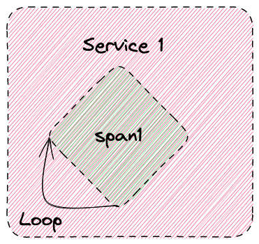

It doesn’t matter how many times that span occurs in a trace either, for example maybe a span is generated within a loop. In code run once, 10 times, 100 times, 1000 times, only a single active series will be produced, where a counter might be increased 1, 10, 100, or 1000 times:
If you looked at the Prometheus data, you’d see an instant value for traces_spanmetrics_call_total similar to the table. Again, one active series for the metric:

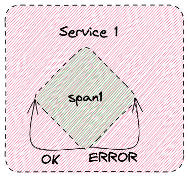

However, let’s now assume that it does loop and there are occasionally errors.
There are now two potential outcomes for a span when the code loops: one where everything successfully completes and one where there is an error.
This means that when the span completes status_code is now either STATUS_CODE_OK or STATUS_CODE_ERROR.
Because of that, the label values can be one of two values on a metric, and we now have two active series being generated based on the status_code, one for the OK status and one for the error.
Again, we could loop once, 10 times, 100, or more times, but there will only ever be two active series.
If we now looked at Prometheus instant values for traces_spanmetrics_call_total, we’d now see the following table:

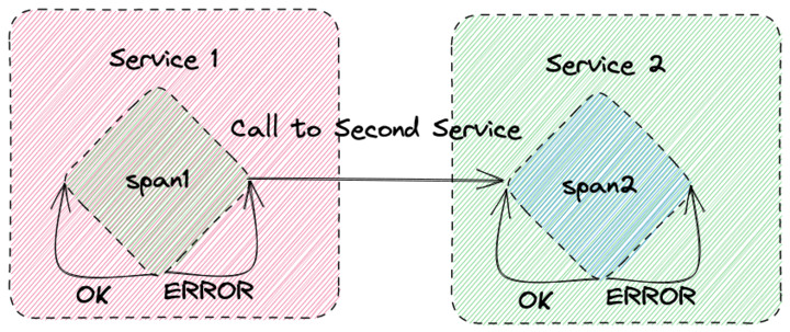

We’ve actually only told half the story in our last diagram. Service 1 called a second service, Service 2, which continues the trace by adding a new span, span2.
If there was a loop inside Service 2 with a single span that was generated from an upstream call from Service 1, and then a number of spans that were driven internally, which could also error, we’d end up with the possible values in the metric for traces_spanmetrics_call_total below:
At this point, all our traces will be composed of two potential span names, each of which produce two separate types of span_kind and two separate types of status_code. So we have eight active series for a metric.
