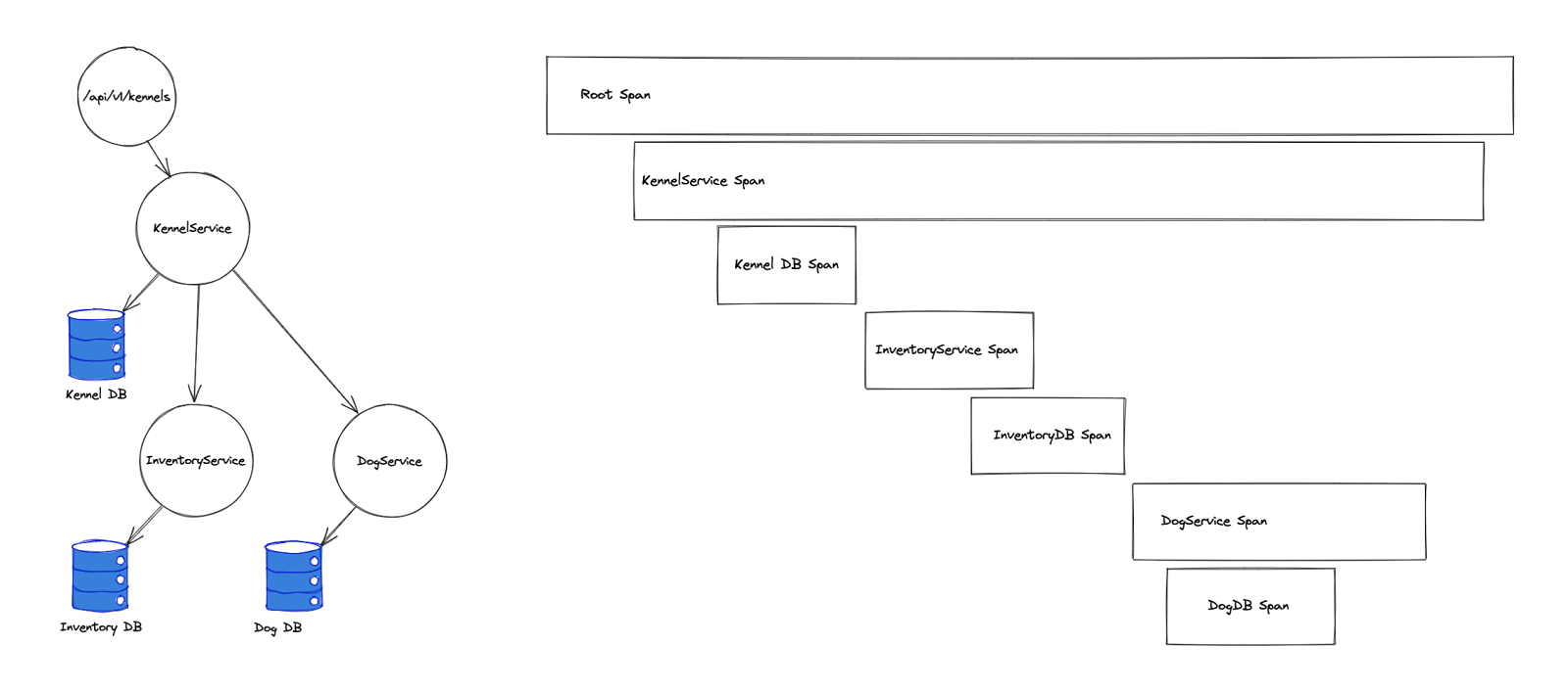

Traces are telemetry data structured as trees. Traces are made of spans (for example, a span tree); there is a root span that can have zero to multiple branches that are called child spans. Each child span can itself be a parent span of one or multiple child spans, and so on so forth.

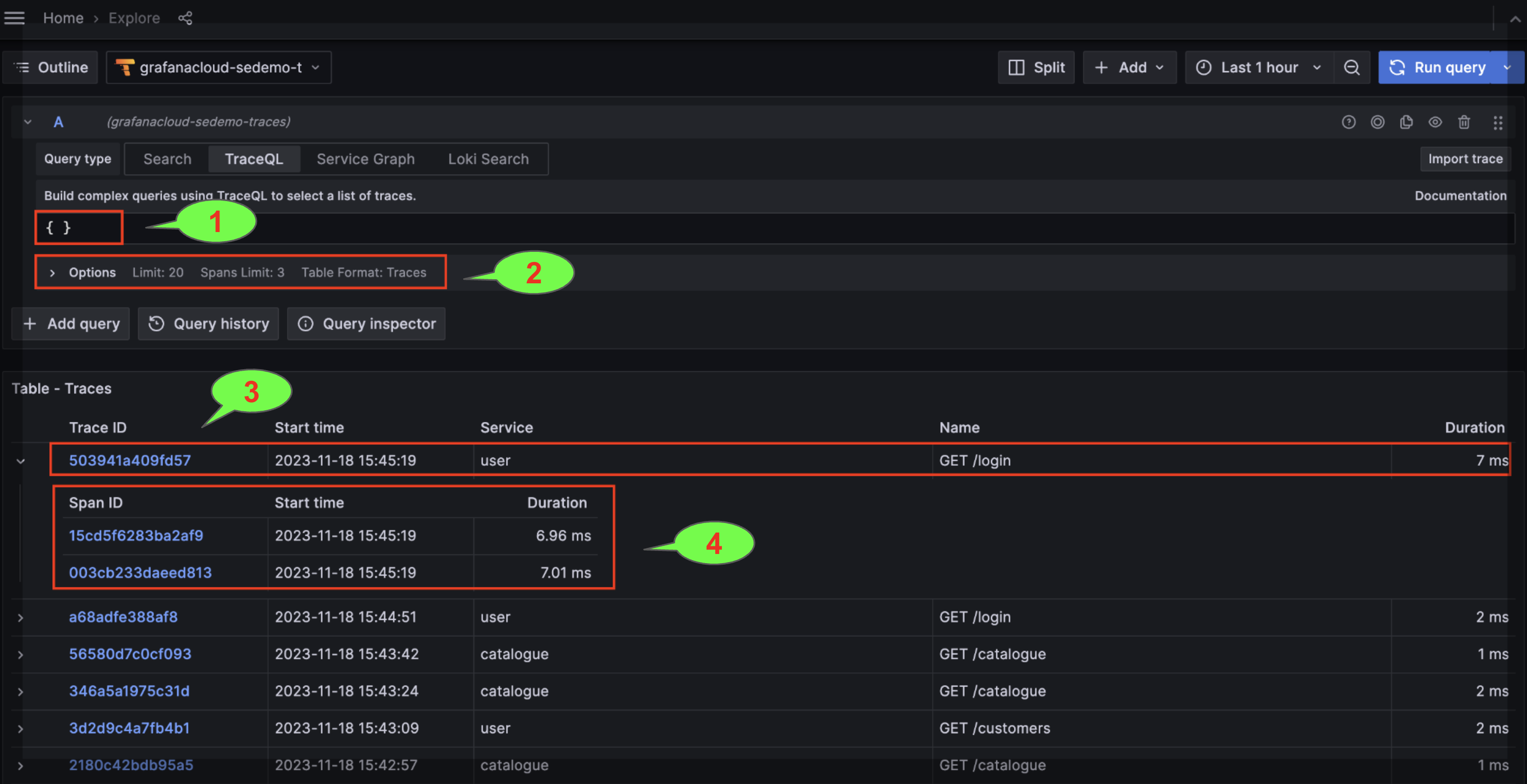

The simplest query is this one:
{ }The curly braces encompass the select/filter conditions. In theory, each span (and the trace it belongs to) matching those conditions is returned by the query. In the previous example, since there are no filter conditions, all spans are matching and thus returned with their associated traces.
In practice, the query is performed against a defined time interval, relative (for example, the last 3 hours) or absolute (for example, from X date-time to Y date-time). The query response is also limited by the number of traces (Limit) and spans per spanset (Span Limit).
- TraceQL query editor
- Query options: Limit, Span Limit and Table Format (Traces or Spans).
- Trace (by Trace ID). The Name and Service columns are displaying the trace root span name and associated service.
- Spans associated to the Trace
